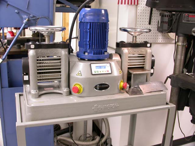

Here's some new tools I got to help with meteorite sheet. The rollers are very powerful and can reduce the thickness of sheet material so less is wasted. The picture shows a meteorite sheet before and after rolling. It went from 3" to over 8" in length.

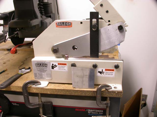

The shear is geared, so is very powerful as well. It can shear about .210" thick steel. I had smaller versions of both tools, but when working with meteorite, found that the larger tools would pay for themselves very quickly. Squashing the one plate like that saves over $800.

Bruce how many patterns are on the pattern side, It looks a lot more advanced than a Cavalinni or Durston, the Bench Shear is nice to, kind of makes me miss making jewelery.

It has 19 square slots and 7 half round slots. I got it just for the flat rollers on the right side. It is a Durston. 1.5hp motor!
