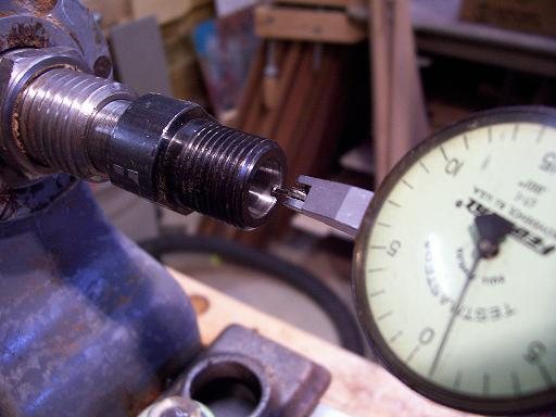

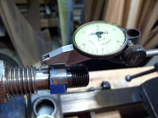

Well here is what i have and I could use some advice on what direction to throw it.And the wife is napping and I have the credit card so where am i going.
Please help.
i get 2 thousands here

I get 12 thousands here

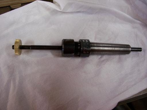

And here is the woodcraft mandrel

Dave,your spindle at .002 doesn't seem bad,but
that is on the outside.What's the inside look like?
that is more critical,in my opinion,since your morse taper
seats inside it.My jet mini checks less than .0005 (tenths)
inside morse taper.You have to have a good start,or connections
only get worse as you go.
The collet chuck is either garbage,or it is getting its runout
from where it seats in your headstock.Check inside of spindle.
You could try a new collet chuck,but you are still trapped
using a mandrel..This is an option,though,and many folks
are happy with a good mandrel set up.I never found <u>mine</u>,though.

The inside is even better than 2 thousands it is close to 1.5.
I am fed up with the mandrels, I have about four out there and most of my problems with them is where the live center seats into it it wears out and starts to run out of round.
Why it wears there is still a little strange to me but i guess if the mandrel is not always running at the same speed as the live center than something is gonna wear.

I had a similar problem with an adjustable mandrel from Craft Supply being out of round. After looking, my morse taper on my lathe was good (never did measure) but when I put in the mandrel without the tailstock, then end of the rod rotated in about a 1" diameter circle. I am fortunate to have a mini-metal lathe. I chucked up the mandrel and recut the surface for the collet to sit on and it improved it 100%. I still need to work on the collet as it is kinda buggered up when I wrenched the mandrel too tight, but the whole thing works great now.
