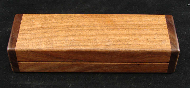

Not sure about you guys, but when I give a fountain pen, I like to include the converter and possibly some extra ink cartridges. The problem is, what the heck do you do with them if you give the pen in a box? I never liked just throwing them in with the pen and letting them roll around together so I came up with a new design. As far as I know, I have never seen a pen box designed like this but there may be something out there. Anyway, this is mesquite with black walnut ends and then pen is a Jr. Something or other :) dressed in Mescalbean with a CA finish. Thoughts?

A lot of commercially available pens such as waterman have an insert with a false bottom which is where these goodies are kept.
Very nice idea Curtis but how about a wooden insert with the centre groove hollowed out for the pen and underneath two hollows on either side to keep these extras hidden?
Does that make sense??

Very nice Curtis. A good way to also include say a smaller pen like a slim or something along with a large pen as well.

Just curious. What does the customer do with the box when they get home? If they just want the pen to carry in a shirt pocket the box will not fit?

Also good for putting in rollerball refill if you don't want to 'load' it prior to shipping, or just a good place to keep the refills. Very nice Curtis!!

Nice design Curtis! I've run into the same problem myself with what to do with the extra "goodies". I like Terry's idea of a false bottom as it keeps everything very clean looking and nothing detracts from the main attraction - the pen!

Gives me an idea for the larger glass top boxes with foam inserts.
I have a cuomer that gifts fountain pens to clients
I can customize the insert to fit the pump!

Nice Curtis, I have always just provided them extras loose. This is a much better idea. Customers have indicated they both use and don't use the box I provide. Will try out the photo contest.

I wonder how it would look if the rear compartment had a foam section with indentations for both a converter AND a cartridge, then the foam was covered with felt flocking?

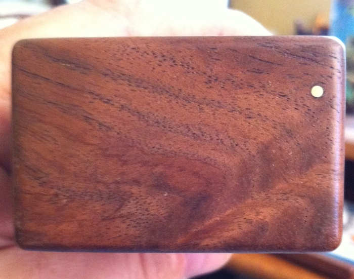

I saw your single box in an earlier post. How do you do the hinge? In the other thread you say you use a brass pin. Is this driven through the end of the box into the lid leaving the pin exposed? Or is the pin spring loaded in the lid and seats into a relief in the inside of the end of the box?
I'm looking to start making boxes and your design seems really flexible in size and materials.
Thanks,
Chris

How did you hinge the lid? Just use pressed in pins?

The top is hinged by drilling a 1/16" diameter hole through the side piece and tapping in a 1/16" brass pin that I make up. It is left just a tiny bit proud of the end piece and then when I sand everything, it gets sanded flush with the end. I'll try to take a pic.

Curtis, very nice 'stylin'. Personally I like to place the 'pin' on the inside of the sides so that they don't show for a cleaner look.:)
Yep, it would work to put the pin hidden but the idea behind this design is to be able to make them fairly quickly. Hiding the pin would take a lot more work the way these go together. Primarily, I glue the ends on to the bottom and then place the top into position, lining everything up. Then I use a jig to drill the hole in just the right place to keep everything nice and flush. Being off just a tiny bit would make it where things are not flush and require a lot more work to get it all flush. I have done it before where I recess the pin and then use some tiny pieces of the same wood with glue to hide the pin. When it is sanded, only the most very observant would notice that it was even there.
