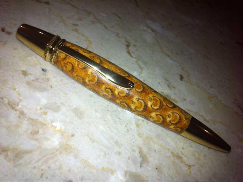

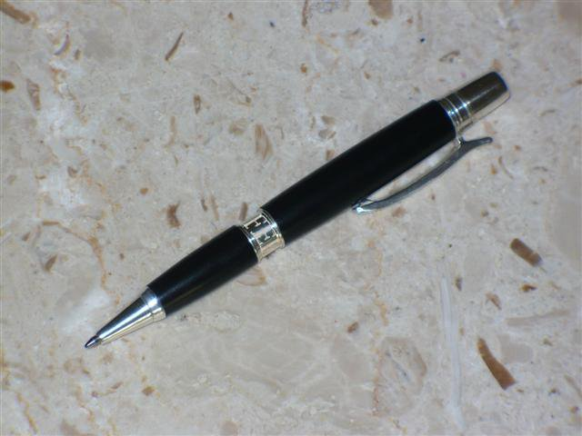

Hi everyone. I'm a new member. I've been making pens as a hobby now for a few years and having TONS of fun (I attached some pics of some of my work) but noticed that my creativity is hindered by my lack of tools and knowledge. For instance, I have seen some pen makers make a pine cone blank by stabilizing a pine cone core. While I have made many pine cone pens, it is painstakingly hard at times because sometimes the core of my pine cone just gets ripped right out of the center and I have to use a bunch of sawdust as filler (takes forever). Any suggestions?

Wow! You guys answer fast! The Polaris kit was a pine cone that I PAINFULLY turned (TOTALLY worth it by the way) by getting a pine cone core that a squirrel ate off the seed pods, drilled through with a sharp bit (also helps to stabilize the ends with gobs of glue and leave about 1/4 inch of room when cutting for blow-outs) and when on the lathe itself, turned a little then sanded smooth, stabilized with a layer of glue and turned a little more and repeat until down to the bushings. Then sanded to 600 grit sandpaper and I use vegetable oil to stain and CA glue (2 coats before sanding) and from there sand from 600 grit to 3200 grit sandpaper...get the idea how long this took?
