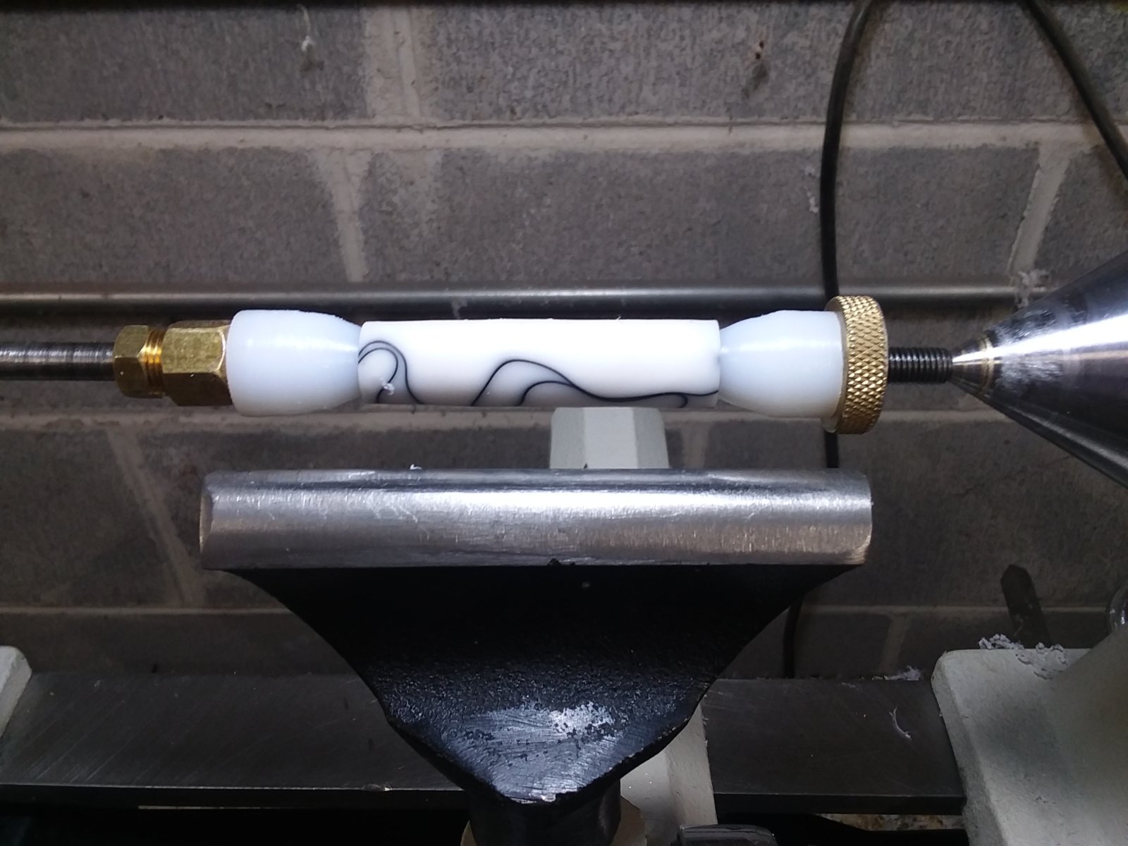

Posted this on another thread. This was one of the ultra-thin turnings that peeled off; for a Woodcraft Princeton kit.
