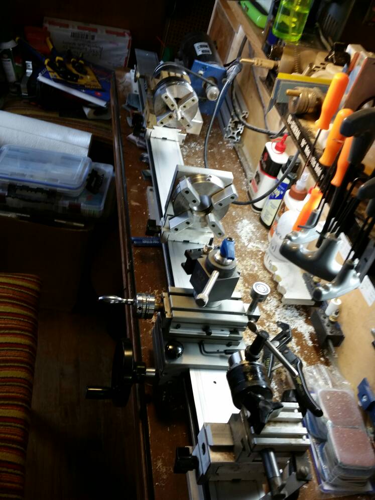

I am a cue repair guy and dabble a little in cue making, I too also have a couple Taig based cue lathes, although mine are from Mid America and not from Chris Hightower. That $700 finishing lathe from Chris could easily be used for turning by adding a carriage and cross slide, but then you're easily up over 1K in cost too.

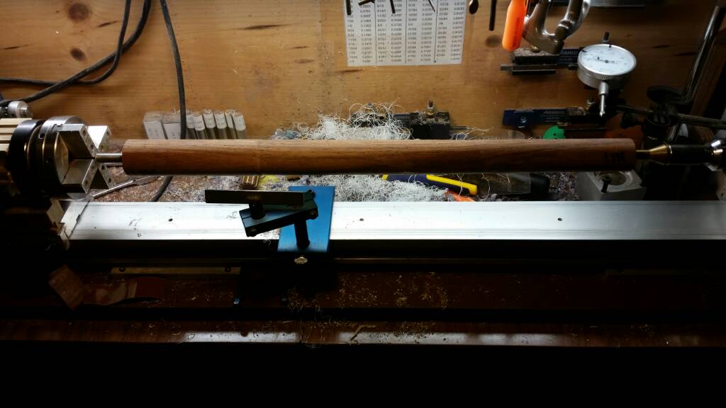

Yeah. I talked to my friend. He's invested much more than 700$ into it. He's makes cue repairs and at first had a shorter lathe. But he's using a bigger full sized for one piece cue size now. I'll try and take a few pics next time I get over there. It does make me want to turn a pen from the Ivorine and Phenolic/Micarta rods used for the ferrules and joint protectors. Or break/jump cue tips. I have wanted to make a pen from those for awhile. I think Atlas had the Ivorine that looks like ivory veins.

LOL, I know his pain, trust me. I have TWO cue lathes and one Jet wood lathe. Of my cue lathes, I have in excess of $2500+ invested in EACH of them and that's about mid scale price wise on these cue lathes nowadays. Here's a pic of one of mine.....

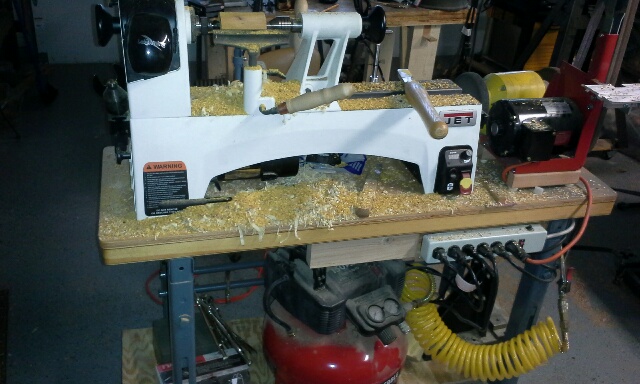

My 1226vs has been a work horse. Love it for pen turning. I mounted it on a industrial sewing machine stand. Very sturdy.

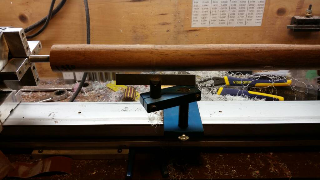

I use to use my Mid America lathe all the time to make pens until I got another dedicated wood lathe. Not a pen set up in it, but I put the slide tool rest on there so you could see what it looks like. If you just get on ebay and type TAIG in the search bar, you can usually find other "attachments" that don't necessarily apply to cue making but still expand the possibilities of your Taig lathe.

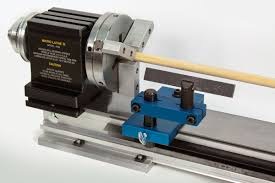

Are you turning between center or mandrel/bushing. I would buy a live Jacobs chuck for the tail stock and simply chuck up with the 4 jaw headstock chuck. Would use a mandrel from the spindle lathe. Does this sound reasonable. How are you turning pen blanks? Thanks
This is the tool post set up I would get....
