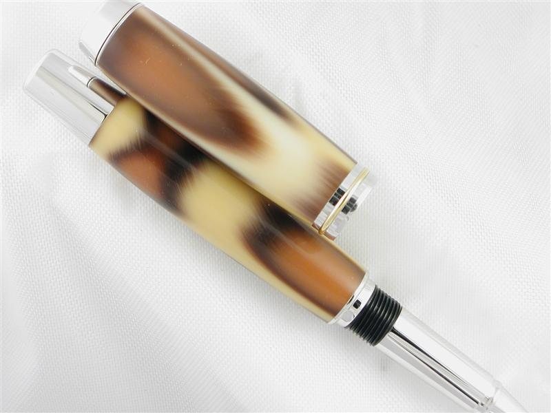

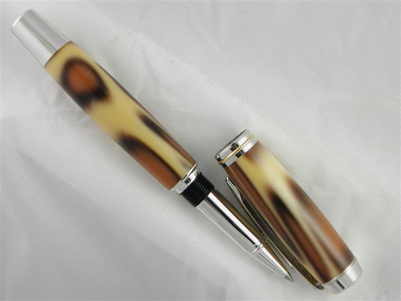

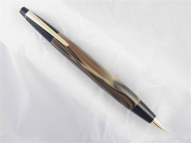

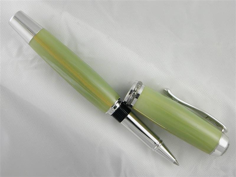

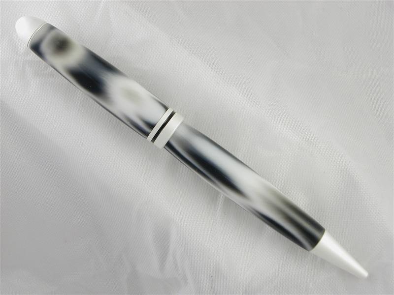

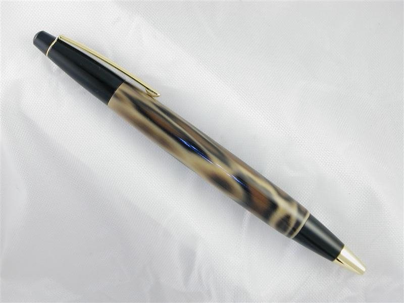

Heres a couple pics of the kitties from Ed's cat. These blanks are awsome. The last one is an Onyx that I through in because I really like how it turned out.

Great looking pens. Hopefully I'll be getting mine within two weeks. Talked to Ed and once extra money comes in I'll be making a litter of kitties.

Thanks everybody. When Ed told me about these new blanks I thought that they would be just some blanks that were spotted to match the colors of different cats. Then I recieved my order and even then I thought that they were nice spotted blanks, it wasn't untill I had the first blanks almost turned that I noticed that it really looked like fur. The lines in the shading is incredable, I didn't expect anything like and I can't figure out how in heck they can make them look so real. They are fun and they turn real nice as long as you have sharp tools and take nice light cuts.
Ed thanks again for bringing these blanks to us.
Wayne

Most interesting Wayne. My wife wants you to send her the second one. That one really looks like fur. Thanks for sharing them with us.

John tell your Wife that it would be much cheaper to buy some blanks for you and have you make it for her. LOL
Shane I sat and looked and for the life of me I cannot figure out how they did it, its really something else.

On a different, but related note-Wayne, THOSE ARE AWESOME!! (I hate that word, but it fits here!!!)
Good material, put in the hands of a great turner, yield excellent results!!!
NICE pens!!!
