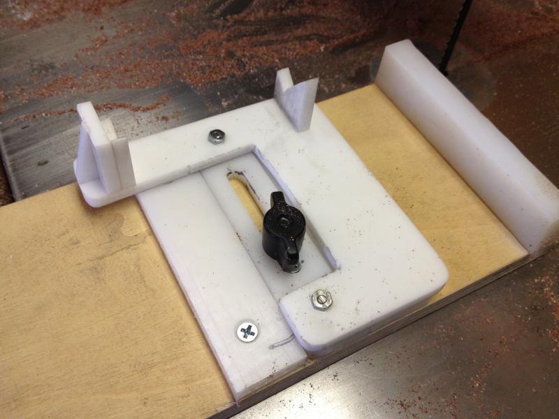

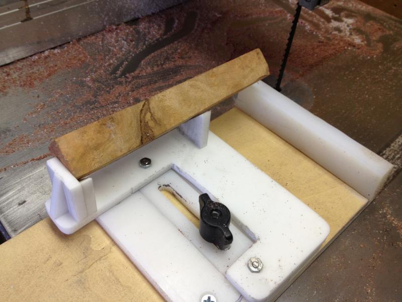

Mr brother inlaw and I came up with a jig to cut the corners off blanks. It,s made of plywood and delrin. It,s adjustable for the diffeferent size blanks. It works good and cuts down on the amount of time it takes to turn a blank.:)

Is there anything locking the blank into place? Looks a bit dicey, but I could be wrong...
I'm not sure if you have used a bandsaw before but you don't need to clamp a piece down, you only need to have something in place to keep the piece from rotating (the v-block) and a stop to push the blank into the blade (plate at the back of the rear v-block). It's as secure as any workpiece fed into a bandsaw, I'm the brother in law and have used this very jig with no worries or incident. :)

Yes, I have a 3HP, 18" Jet... but it's difficult to tell the complete construction from the photos. From the look of it, the blank hangs off the end of the V-block set, which means a fulcrum being pulled down at one end by a cutting blade. What's preventing the blank from tipping right into the blade?

The block of delrin at the end that goes into the blade first supports it and when you get to the last side there is a piece that slides on to support the missing corner. It's not my first time with a bandsaw either, full fledged machinist for 25 years with two years in jig and fixture design. And yes I still have eight full length functioning fingers as well as two rather spectacular thumbs! I understand your concern with support and I hope this answers your questions.
