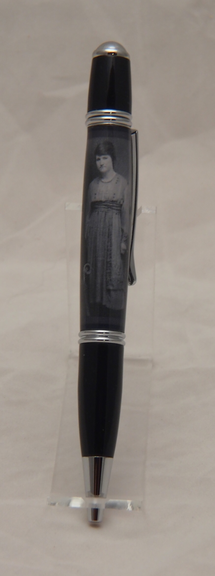

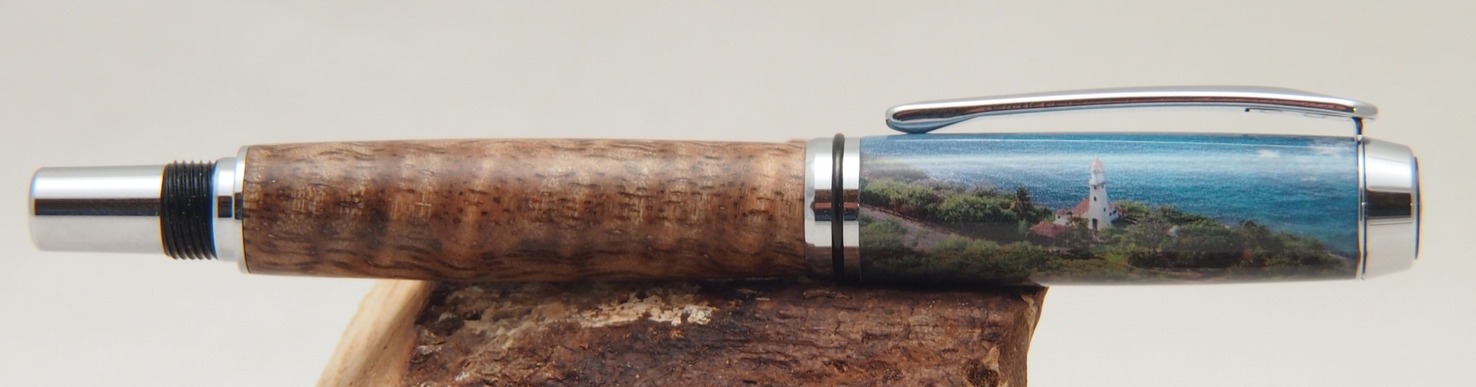

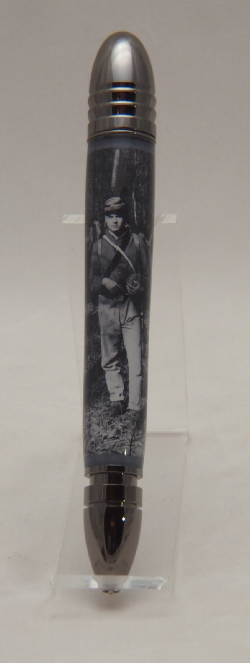

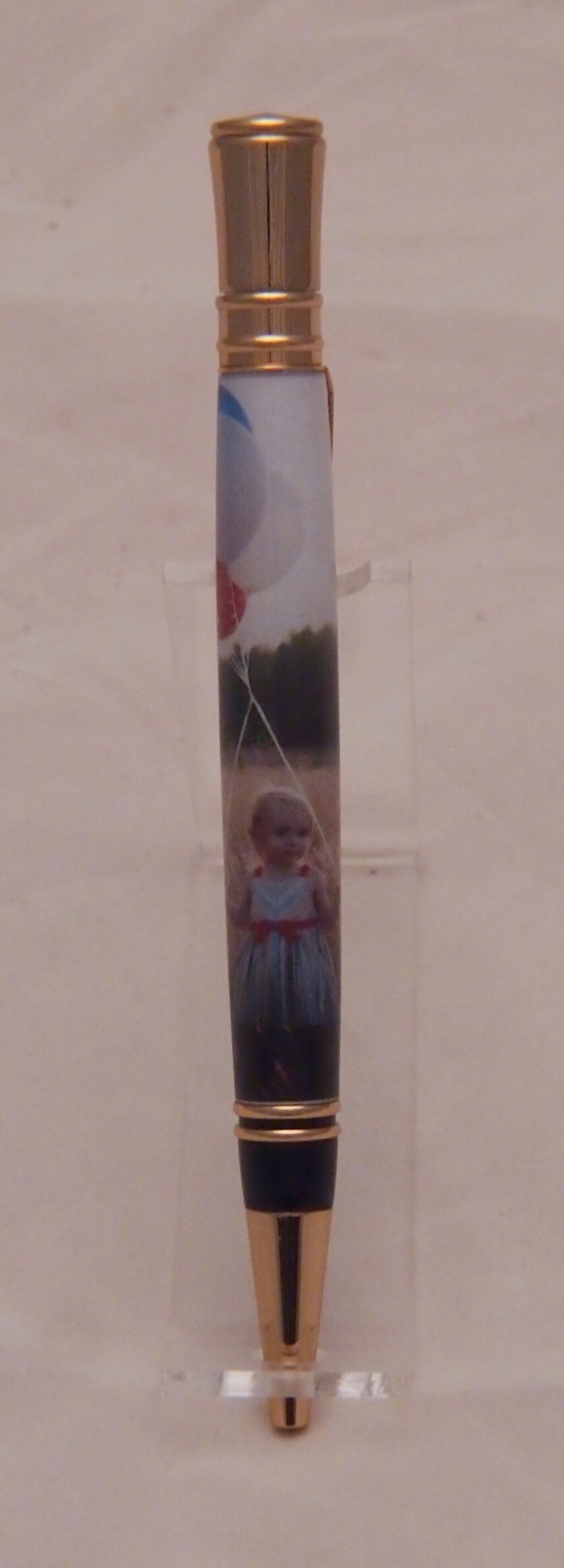

Tony, I would suspect the process is the same as snakeskins, feathers, Chiyogami, etc.
Adhere the picture to the tube, cast in clear resin.
There are a number of ways this can be done, a little experimentation will get you the right adhesive and how to cast without bubbles or separation.
