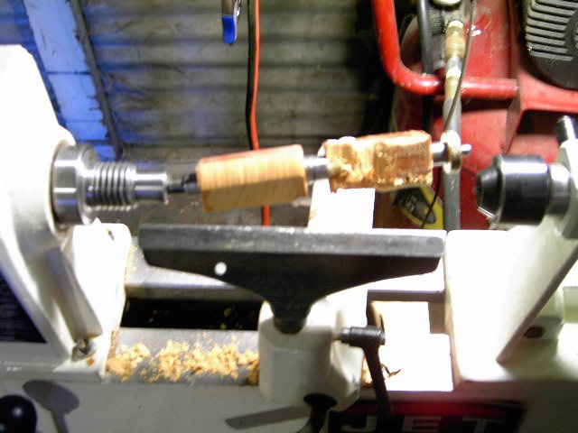

At least you didn't do this:
[:I]
As for blowouts, I've had plenty especially with cocobolo. I started using a scraper to get the final sizing on blanks I tend to blow.
Don't give up you'll get it eventually. By the way, I've since replaced the stock live center with a 60 degree one, makes a BIG difference.

It's really quite simple. First blow out a piece of the blank when you first start trying to round it out. Then decide that since the blank is ruined you're going to save the tube by turning off the remaining wood. In your frustration decide you're going to do it quickly by jamming the skew into the edge of the existing blowout to create a bigger blow out and before you now it you too will have a one of a kind mandrel[}:)]
Looking back the good news was that was the only mandrel I had at the time so I had several days to think about my stupidity before I could do anything on the lathe again.
