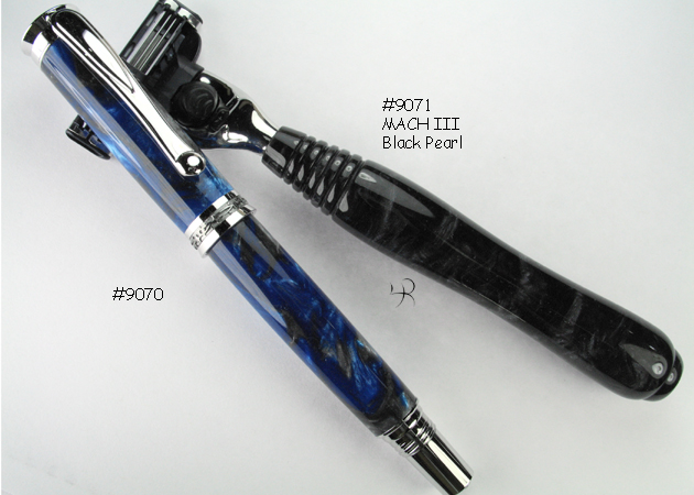

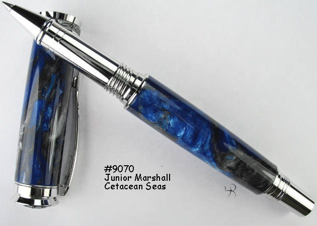

Photo 1 - A Junior Marshall Rollerball dressed in Cetacean Seas.

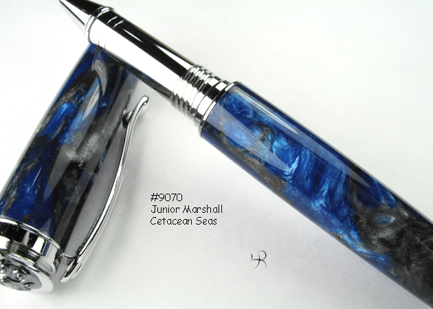

Photo 2: Close up in an attempt to catch the pearl effect better.

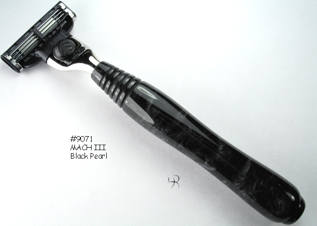

Photo 3: The reason I discovered this material. The plan was only to make a couple Mach III rasors as Christmas gifts for my sons. Wood being not really appropriate for the water exposure -
Photo 4: Together
I think I'll be using more of this stuff.
Thanks for looking.

I am curious if you painted the tubes/blanks? If so, was it dark or light colored?
I have a few of those blanks I am about to turn, and they don't look that dark, and just wondering what effect the painted tubes will have. May do different on 3 of them to get different results on all 3.

Thanks Chris. Yup, I painted the inside of the blanks blue and used a chemical solution to blacken the tubes.

Both look great, I really like the "indents" in the razor handle. Very practical for soapy hands.
Great polish too, did you buff or use some type of really good plastic polish???

Thanks Ed. This is easy with your blanks! I turned them with one tool, a 1" roughing gouge (very sharp), sanded with P320, P400, P600 then added the details with a beading tool. Switched to wet sanding; wet/dry 600 and 1000 followed by MM from 2400 up. The only other product I used is Maguiar's Paste Car Wax, and usually one coat, buffed with a micro fibre cloth by hand.
I do hide the turning center in the handle end with a 1/4" MOP or Abalone dot depending on the blank at the time. I've never figured out how to show this detail in a flattering photo but it does add to the appearance.
