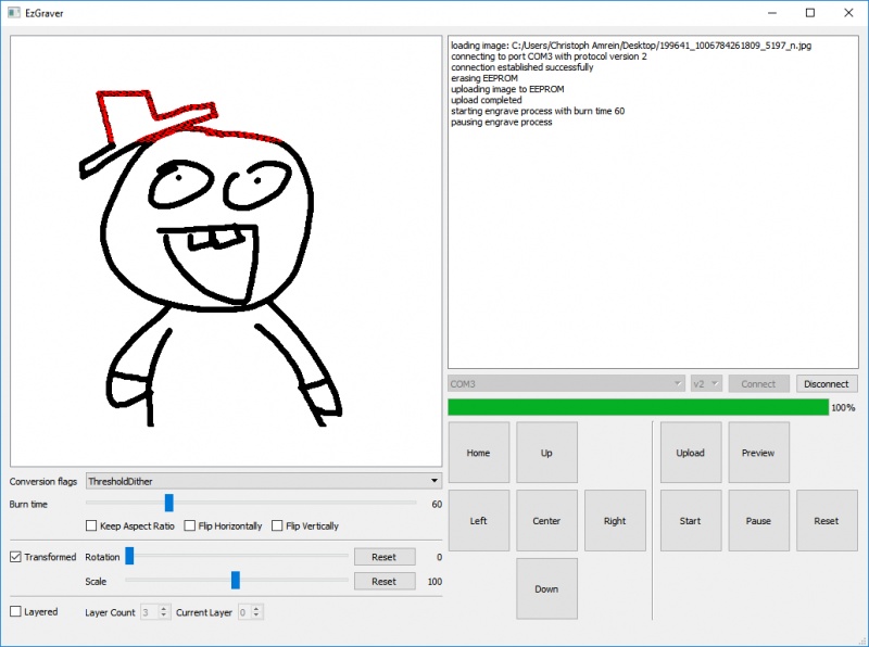

I use an different program called EzGraver. Not sure where its from but it has a lot more features than the software that came with the unit including dithering and sort a layered color separation thing. I don't think I ever found any real documentation but is there really any for the "OEM" software.
I've had mixed results using the dither and layer options.
https://github.com/camrein/EzGraver
https://github.com/camrein/EzGraver/releases

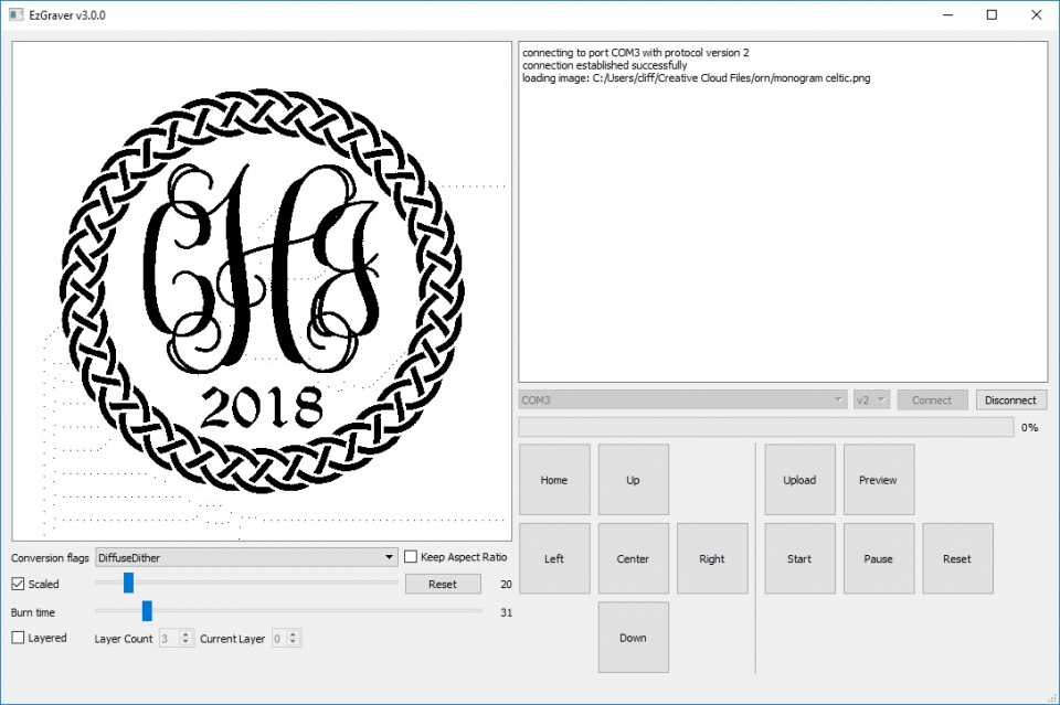

Cliff, how did you get EzGraver to work with your machine? I've had no luck with it.
I have the 1,000mw machine and just hooked it up, selected the port, COM3 for me, and pick either v1 or v2. they both seem to work.
This is a slightly older version I just found the newer version yesterday. Its a signature I'm working on for the bottom of my bowls. Plan is to glue a wooden coin in a recess.
