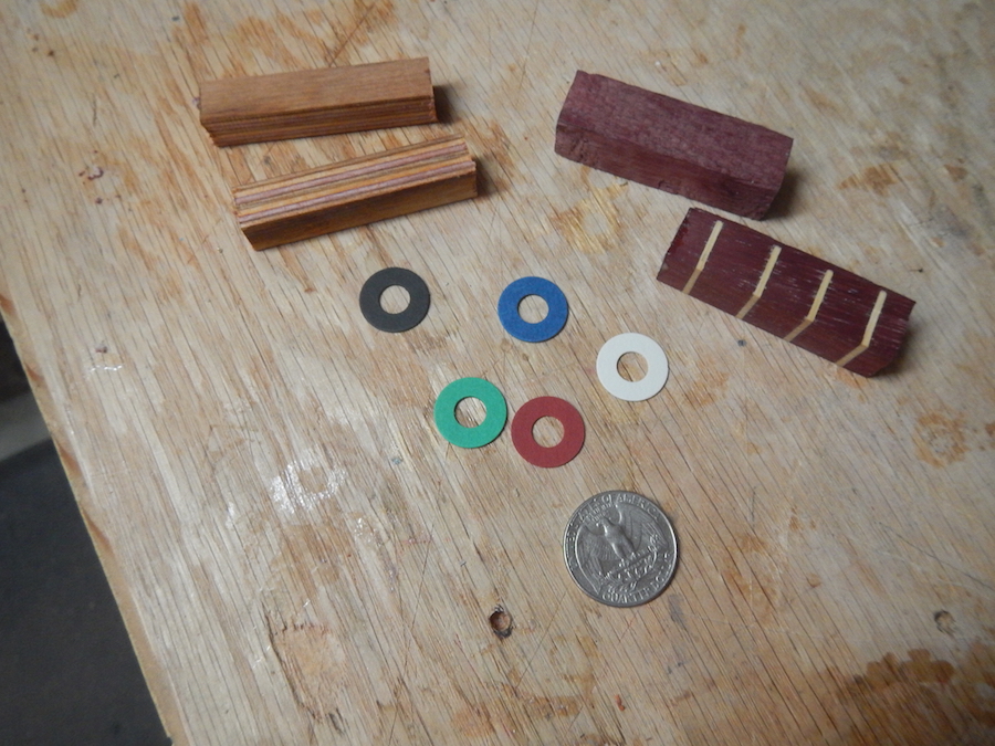

Atlas quit making and selling these long ago.
I use them quite a lot in the 7mm pens as highlight rings.
Is there another source for them?
If not then I see an oppertunity for one of the pen turner supplyers to contact Atlas Fiber and have some made up ... They still have the dies I bet.
I would order 1000 of each color if available.

The washers are made of a hard fiber material that cut and finished nicely.
They were custom sized for the 7MM pen tubes.
They could be used on other kits by drilling them out.
I use a lot of them in my slimline pens to accent various rings.

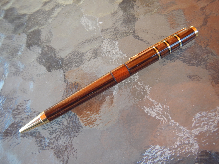

Here is a photo of a pen using the black washers on either side of the brass washers to accent them from the wood.
To make them out of thin veneer would take a lot of time and special tooling.
