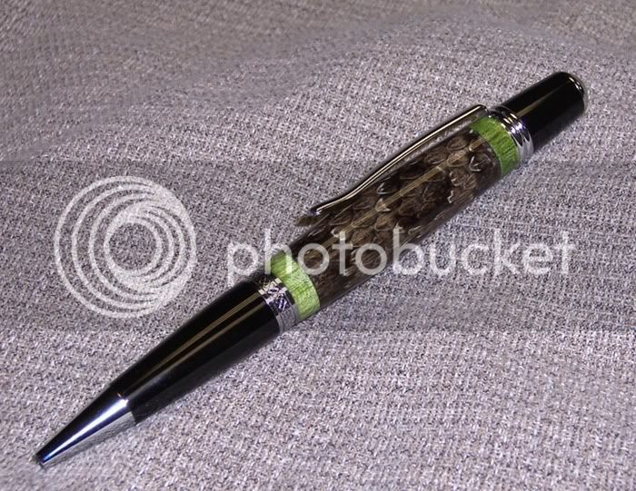

I've made an oops band in one. I just parted all the way down to the skin, the plastic comes away from the skin. Used a carpet knife to cut through the skin, then scraped it off with the razor.
(ignore the sanding lines, I was testing something out, lol)
CaptG
Jan 3, 2007
2,686
Otsego, Mi, USA.
Thanks for the input. I will be trying your suggestions as soon as the temp. comes back up in the shop. Skye, Nice looking pen,what are the green bands?
