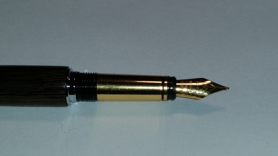

Well, I'm CLOSE. I have a box of parts and unidentified pieces, and this one fits.
The problem is I have no idea what kit it's from! Can anyone identify it?
