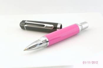

Hot Pink
I did this pen a little bit ago. Is it pink enough? I'm thinking it's the solid pink fom PSI - backpainted white.

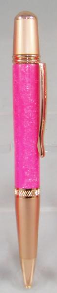

Republic, Mo.
I made this home cast last year, and painted the tube silver. And just because I could, I added a bubblegum scent to the pen.

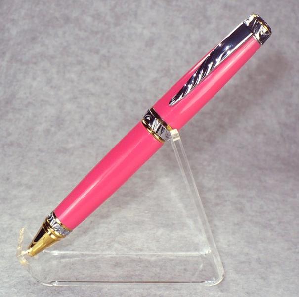

dplloyd
Jul 24, 2010
152
Pearland, TX
Pink Flamingo looks really nice. It's has a silvery streak and it looks shiny but not enough ot over power the pen. Woodcraft carries it.

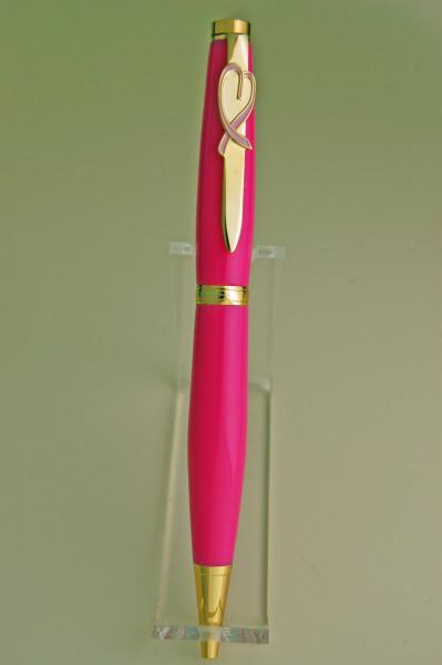

Southern California
Made this the other day. Hot Pink acrylic from Bear Tooth Woods and clip from WoodnWhimsies.
-J
randywa
Jul 31, 2008
893
Republic, Mo.
How, pray tell?
I ran into a guy who formulates scents for a living and he gave me some sample scents. I cut some disc's to fit inside the tubes and soaked them in the juice. After a year it still smells like bubble gum.
With the scents being oily, I'm not sure if I could add it to the resin when casting, but it might be worth a try.

edicehouse
Jun 8, 2011
3,515
Suffolk, VA
Kelly, that looks like pink flamino. That is the blank the guy ended up getting, I back painted it red, and he knows his wife is going to flip out about it.
