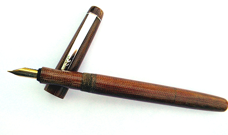

Need help and or suggestions for taking photos.
This was shot outdoors in shade with a piece of printer paper for a background. It almost took sort of almost OK except for the problem with the clip and the nib not showing up as they should.
This wasn't my first try, wish it was, but it's about 6 down the line from it. It's the best I can achieve so far without some advice on what to do next.
So where do I go from here to try to get a better picture? Better camera? Photo editor? If so which one?
(FWIW, this was just a simple pen I made from scraps of stuff I had laying around and a clip salvaged from -IIRC- a papermate I took it off of when threw it away. Nothing speical but I thought I might use it for experimenting because it has a fair amount of detail I thought might be good to learn photo taking with to try getting a reasonably decent photo -something I haven't achieved yet).
