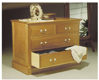

I purchased the plans for this one. I need some time to digest the scope of it but there are mostly mortise and tenons and some things are screwed together. I may vary from the plans somewhat as it does not use drawer slides.
But now that I think of it, metal drawer slides are not really heirloom stile either.:rolleyes:

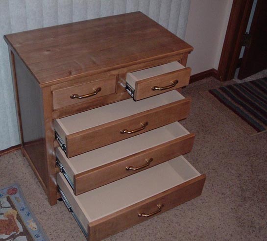

I built this about a year ago and it is still holding together well. It is about half the size of the dresser so I will need to rethink my shop and assembly area. But it should be a fun winter-long project. This one is maple with a stain. The dresser may be cherry with no stain. I don't mind if it darkens over time.
