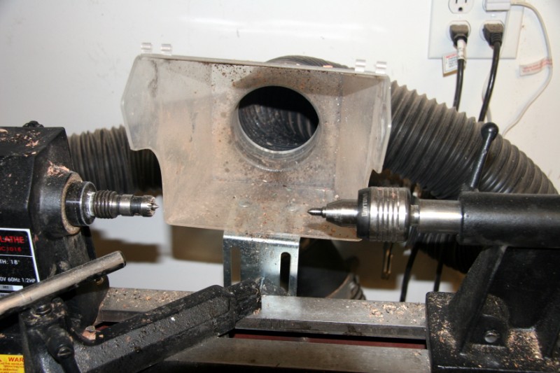

I have this hood from Rockler.
http://www.rockler.com/product.cfm?page=10578&filter=dust lathe
I removed the clamp and replaced it with a big magnet (2" square and an inch thick). I can slide it up and down the bed for working on longer items. For pens it is just the right size. I took the little deflector off.
and this dust collector
http://www.jettools.com/us/manufacturing/en/product.html?node=4524&product=273494
I've been very happy with the combo. I have a gated "Y" that allows me to pick up from the lathe and/or table saw.

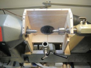

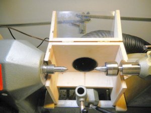

I uploaded two photos to my photo album of my pen making hood and dust collection. I copied this from someone here on IAP. Curtis?, Bitshird? In any case I give credit where due.

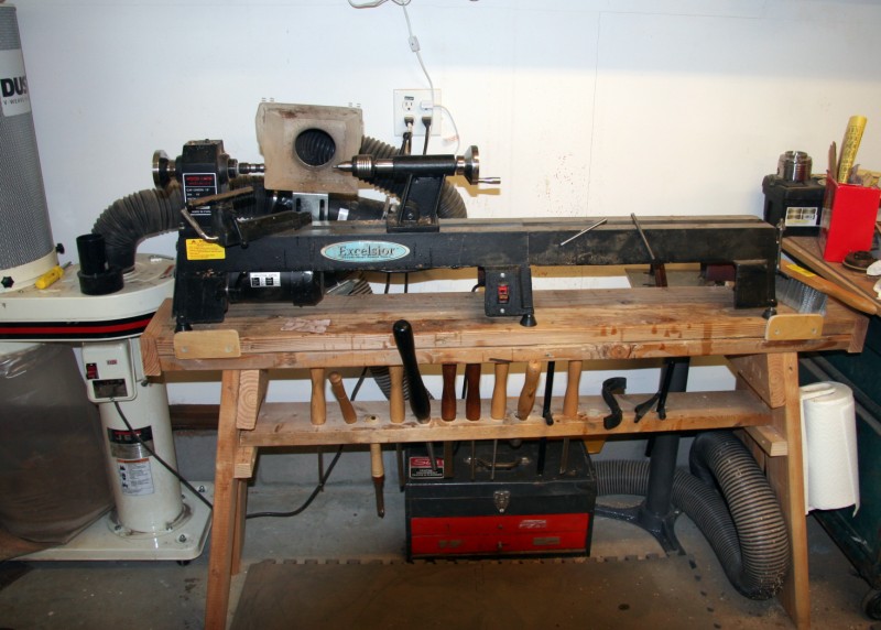

Here is my DC and lathe hood
That would be me! Glad you thought enough of it to make your own! How's it working for you?
