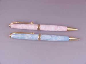

The brass tubes are showing through this beautiful blank. I do have a same second blank to complete the pen.
I will repeat what Skiprat said. Paint the Inside of the drilled hole, not the tube. This will cover any glue "see-thru".
In addition, you can use different or contrasting colors to completely change the appearance of the pen. These two pens are the same white pearlescent blank, but painted different colors
