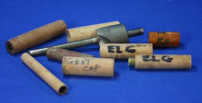

Like lazyguy Douglas said...make your own sleeves and spend the savings on tools that you can't make.:biggrin::biggrin:
Do a good turn daily!
Don

Don's got the right idea. I bought one of the mill kits we had a group buy on here for, but there are still a few that aren't 'just right'. I make mine out of nylon bushings. They slip better and hold straighter than wood.
