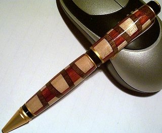

of the Morning After. I loved the tutorial and have been dying to make this pen:D
Comments and critiques are always welcome

I am really starting to like this segmented stuff. Super nice lookin. What thype of glue did you use? It seems I had to realy hurry on the CA to get it in place (right) before it sets up.

You don't have to hurry too much if you have everything cut and ready to go at you glue station..
I did a Sierra like this one for a gift and you just glue the bottom wood piece to a page of an old phone book with MED CA, then a little around the end of the tube and slide it into the forst wood piece. That way your tube point up. A small ring of glue on the wood and on with the next wood piece, until you have them all on the tube. Squeeze down and then spray with accelerator.

Like Bob said...you can use Medium or for me I used thick CA, just make sure all your parts are set and ready to go. I personally use wax paper so it comes off the glued end easy but that is personal preference.

I use the WC vise as well [V]...it has taken some time to get it dialed in with my drill press but I am very, very close now as long as the blanks are square...I have had to trim a couple of blanks from WC to make sure they drilled straight... I guess I should try to get on Paul's list...it is just sooooooo very long.

Every time I see one of my designs posted it reminds me why I work so hard on new goodies for everyone! You did good....real good.
If I may ask...What is the dark wood?

The dark wood is walnut...

Wow, very nice work. I can't imagine how much time it takes to do something like that. Did you get the original blank from Ron? I know he sells them (I think it is called the checkerboard).

I got these blanks off of ebay from Steven...I believe they are the same blanks...Ron???Can you answer that question?

Yes....The blanks that you purchased from Steve are exactly the same blanks that I sell called checkerboards. Steve and I have been friends for a while now and due to the volume of the blanks I was buying we came to a mutually beneficial business agreement. He makes them and I sell them.
Jim,
The only blank that he got off of eBay would be the checkerboard blank. That is what is needed to begin making a pen based on my tutorial.[;)]

I tried to make these blanks but my bandsaw is not very good so long cuts do not come out very good...I tried on my table saw but the blanks were coming out too small because of the size of the blade, got new thinner blade...out of 6 blanks (3 each)of bloodwood and birds eye maple I had one that turned out pretty darn good...but I did not have enough glue in part of the checkerboard stage so when I went to turn it it blew up and I had this huge gaping hole in the middle of my pen![xx(]At that point I said forget it and bought it from Steven. [:D] Much easier and saved a ton of time and effort! I could probably now be able to make these blanks but for the time it would take me to make them, it costs less to buy them from Ron or Steven with the same or better results.
