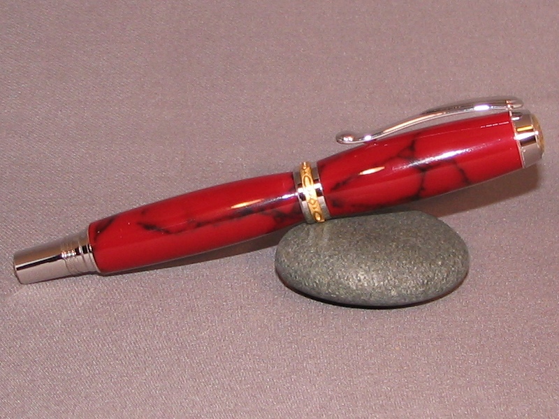

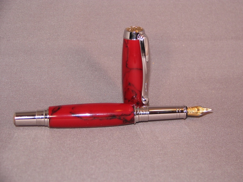

If you saw the movie Gone in 60 Seconds....this is my unicorn, my Elenor...if not...well....watch the movie.....
This took 3 blanks to finish. Jr. Statesman wrapped in red Truestone. On the first blank, I started pressing in the cap (last step) and it chipped off....set it aside because it was the only one I had.
Picked up another, cut the blank for the cap, drilled it, mounted the tube, turned it, finished it and then......did it again! I had used the other part of the blank for another pen so.....back to the store.....
Third time was the charm. Elapse time......4 months. Now when someone asks how long, I can answer truthfully "4 months".
Thanks for looking...please ignore the fingerprints.

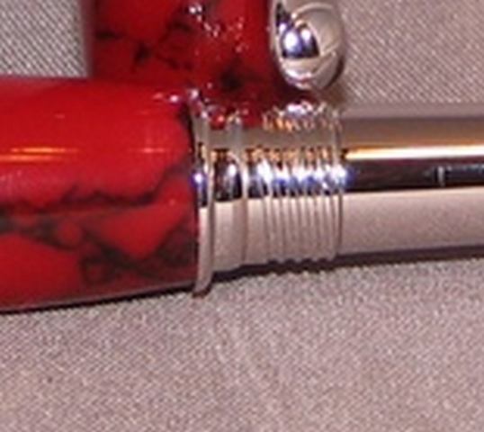

Well, I named her right....James sent me a pm....I made a mistake on this pen. I have fixed it now. No new photgraphs unless I decide to put it on my site.
Anyone else pick out my error? We might as well make this educational.

Yes, I found the slight mis-mounting.

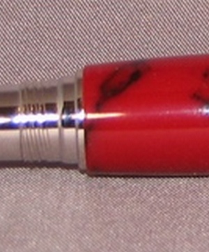

Charles, I was so focused on the cap, finally getting one completed, and matching the pattern as well as I could to the barrell, that I swapped ends on the barrell. One end is slightly smaller than the other. You can see it if if you look close. You can feel it pretty easily. It is only a few hundredths off but it is enough. It is an easy mistake to make but you would think that after making as many of these as I have, I would get it right (LOL)......you ought to see my Cigar mistakes.
Red seems to be the only Trustone that gives me trouble. I cropped the original photos so you could see what the issue was. I did not take new photos but the fit is right on now.
