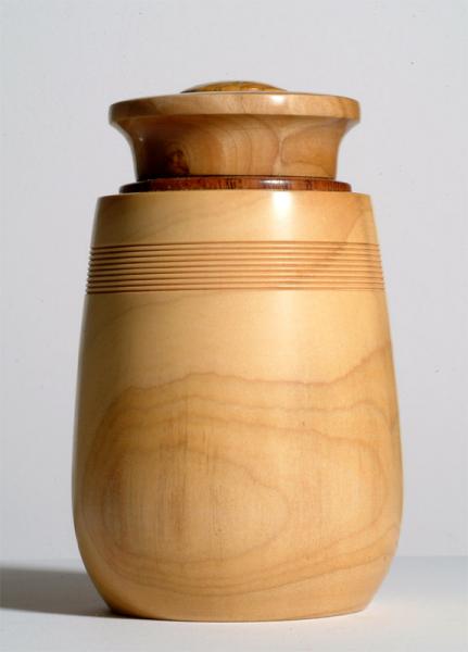

Vic;
I just tried fotosizer - I've attached to shots. The first is a 92k original file that triggered the IAP compression routine that took it down to 18K, the other I did using fotoziser, making the short measurement 288 (about 4") and setting quality to 100 percent. To me the IAP compression is very slightly better than fotosizer. Neither looks as good as the original, which is here:
http://www.penturners.org/photos/index.php?n=1894
Compare the fine line decoration to see the difference.
Did your camera come with some kind of imaging program? It look to me like you would be better off with that.
Marc

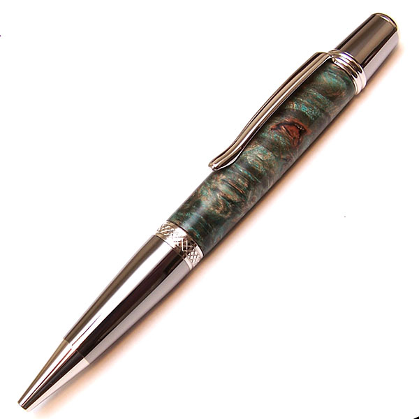

Hmm... Here's a test.
This photo is hosted on my own server:
And here's the exact same file uploaded. Note that it is smaller than the limits. Just seeing if there's a difference in quality when the resizer isn't activated.

Interesting... The first click display *IS* resized, but it still doesn't look bad. Second click of course shows the full file and that looks fine.
