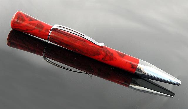

I hope this lives up to some of the accolades you guys gave me for being accepted into the guild.[:I]
A bit more subtle than I have been doing lately. Crimson Tide Poly Gem blank, stainless tapered hexagonal nib. The clip is from a kit and just modified to fit. The mech is in the top section and threaded coupler was modified to fit in the 7mm tube.
Thanks to Pat L. of PMG for the nice pic

Steven - I'm with you in that this is not my favorite pen of those you have shown, however, it is still an excellent example of the kind of work the Guild looks for. BTW, with using these steel bolts and others odds and ends, how much do these pens end up weighing? Are they significantly different from the kit pens or from the name brand manufactured pens?

Excellent point Lou. It has been a concern for me too. So I have started weighing them. I do try and make the parts a light as possible and often drill 4 reducing sized holes in the nibs.
This pen weighs 32g. It is approx 9mm dia where the nib meets the blank. It has a 7mm hole for the tube, then 5mm then 3.5 then 2.5 for the refill point. Some are completely unusable like the almost solid brass and blue acrylic one I made way back, that was a whopping 85g!!!!
Here are some weights of some of mine and some stock standards that I have, just for comparison. I would be very interested in what is an 'acceptable' weight for various pens?
B2B CSUSA Ltd Ed Emp FP capped = 77g, uncapped = 43g
B2B CSUSA Broker pen = 41g
B2B CSUSA Flat Top = 39g
B2B CSUSA SL = 23g
My recent cobalt/stainless = 40g
My recent hex / blue cobra = 33g
My Greta FP capped = 38g
My Greta SL = 27g
My black DAPR pen capped = 31g
My recent black ringed stainless SL = 29g
So I think as long as I can keep them thin walled and drill out as much as possible then they should be ok.[8D]
Thanks again for all the very nice comments.[:D]

Steven - I think 32 grams (about 1 ounce for those who are metric illiterate) is a reasonable weight. Most of the kits sold in the US run at least that much and up to 75-80 grams. To me, those weights are absurd. It shows that the designers do not understand the mechanics of comfortable writing. I'd like to be able to get my average fountain pen or rollerball down into the low 20's but haven't been able to accomplish it...yet! Your work, and that of others, inspires me to push on. And your work is beautiful!
