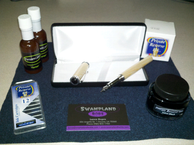

I just received my PITH pen from LanceD yesterday and I must say I am impressed. I am also happy with the extras received. Going to try out that hot sauce soon.

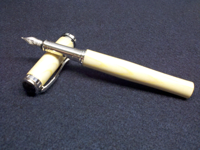

I have to ask what finish is on the pen? Something about the way it feels is real comfortable. Smooth but with a nice grip.
Thanks for everything Lance!

Larry, glad you like the pen. About the finish, well it's 7 coats of mild hot sauce then 3 coats of throat puckering extra hot Cajun specialty sauce then polished with several crushed up alka seltzer for that deep gloss shine :biggrin:.
Seriously it's only about 7 coats of med. CA then 600 grit wet sanded , then MM up to 4000 then a good polishing with Novus 2 polish.
