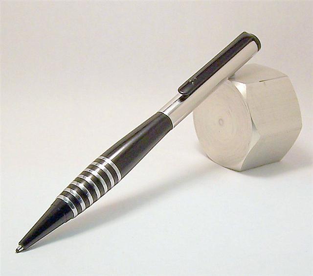

I have always have loved the slimline. I can't understand why some folks think they are a lesser pen than any other. With the exception of pens that need a tenon ( tendon to some ;) ) I don't believe they are any simpler to make either.
This is a stainless steel bolt shaft for the top half with stainless steel washers in the bottom half. The black is of course PR Princess' cool PR. :D I 'oversanded' around the rings to make grip ridges.

Originally posted by JasonF
<br />Another great looking pen! Steven, are you using a metal lathe to turn these down?
This was my queston also. What type of lathe and what tools? By the way great job as usual [:p]

Originally posted by Milpaul
<br />
Thanks.[:D]
Yes, I do often use my metal lathe on the stainless steel using normal HSS bits. However, it really is just as easy to do on a wood lathe. I still use a file to turn steel more often than not though, especially when I need some shaping. The hardest part is drilling down the centre. I have broken more centre drills than I will ever tell my wife!!!!

Originally posted by fuzzydog
<br />Beautiful work!
Does using the bolt in the upper half of the barrel make this pen a bit top heavy?
David
Normally would, but to keep it light, I did it B2B. I also drilled a 7mm hole by mistake. I meant to use a 6.3mm as I wasn't going to use the brass tube. Maybe the brass tube with a layer of CA is fractionally lighter than the removed metal? [:)]

Originally posted by Rmartin
<br />Outstanding! So you use a file to turn the washers, hmmm......I think I'll have to give it a go.
Word of warning: Be prepared to lubricate (oil or water).

Originally posted by ed4copies
<br />
Here's how I turn washers with a file.
1. Drill the inside holes to the required size - did mine on the lathe
2. De-burr them.
3. Flat washers are NOT flat - sort them so they are all the same way round.
4. Stack them all together and slip them onto a piece of brass tube to keep them centred.
5. Use any old slimline bushes so that the whole lot can be tightened up on the mandrel. (Or stack them on a nut and bolt)
6. Use a good file and while the washers are spinning, lightly hold the file on top of the washers and get them all flush with each other.
7. Just file one side more if you want them to taper in size. Don't mix them up when you come to glueing[xx(]
I don't lubricate ( Sorry Ed [:I] ) I want the tool to cut, not slide over the washers. But I do keep the file spotless by constant cleaning with a wire brush. Any filings clogging the file will put a deep gouge in the metal. Still on the lathe, clean them up with wet and dry ( Now lubricated )till all the scratches are gone.[:D]

ed4copies
Local Chapter Manager
Mar 25, 2005
24,529
Racine, WI, USA.
No problem, Steve. But you must turn fairly slowly. I have tried filing washers and the heat built up pretty quickly. (You will notice I have never posted anything using this technique - now you have a clue WHY!!)
Or your file is MUCH better than my HF model?????
