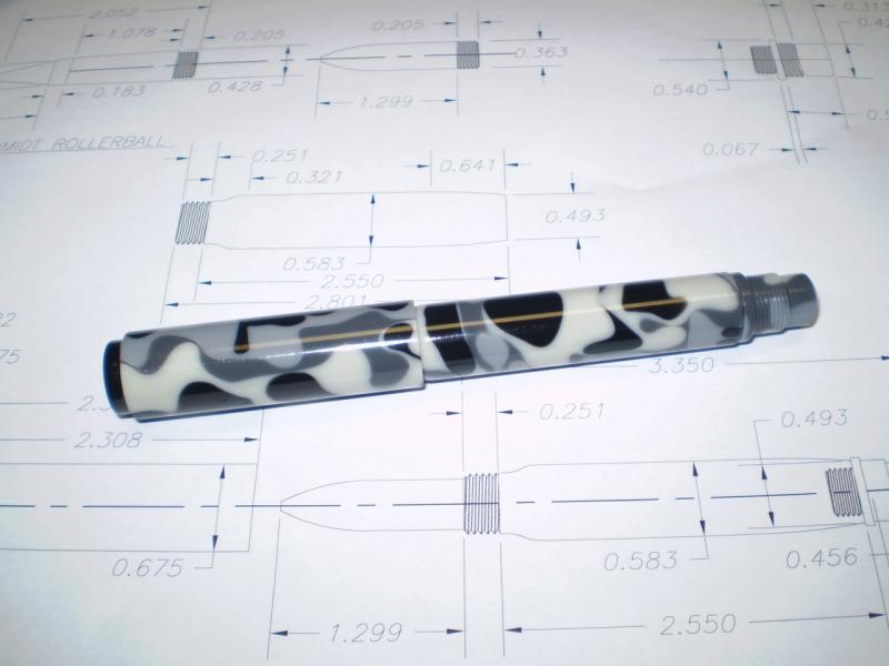

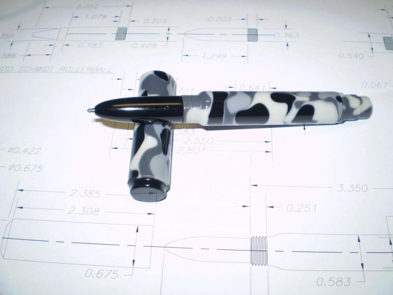

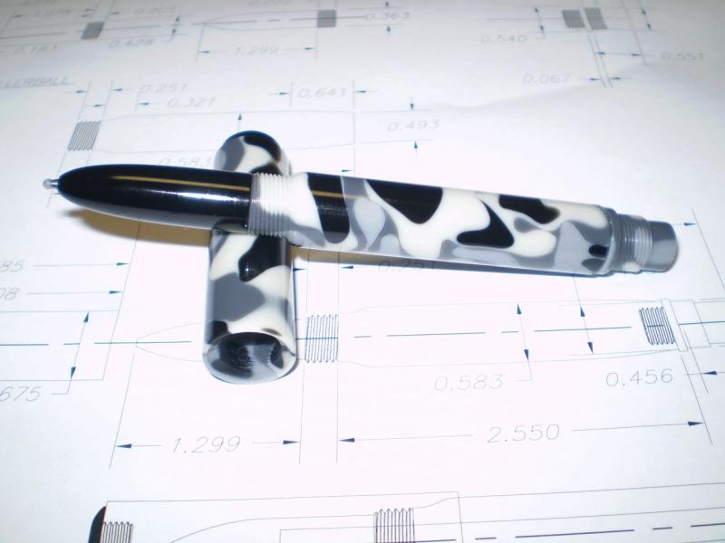

Well, its finally finished. Used the multi start set for the cap and nib and postable end. Metric for everything else. I had some extra time at lunch one day and sketched up a set of cartoons for it too. Hope you all like it. All and any comments welcomed.

Pretty nice kit less. the square sends seem to make it look heavy, I wonder if the cap were a bit tapered into the center band area if it would have the same durability.

Ken,
It's really not that heavy. Shorter than I'm used to but not by much, and it is fairly comfortable to hold. I messed up the schmidt style nib and went with the blunted look. I wanted to try something different than just having a step where the nib meets the barrel, hence the smallish arc. With that accomplished, I felt it necessary to cover that transition with the cap, thereby making her a bit fatter in the hips.....
