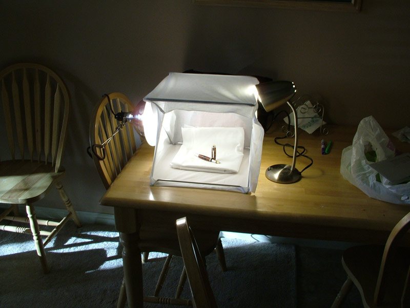

I have been trying to talk my wife into letting me pick up some materials for making a light box for months now but it seems that every time I'm ready to go shopping, something comes up and the budget for 'extras' is gone. After waiting all this time, I ended up getting the frame for $3.49 on clearance and the fabric for $3.00. Technically I did buy the lamp on the left for $5.99 and some daylight bulbs for $2.00, so I guess you could say I paid closer to $15 for it all (I already had the lamp on the right).
The metal frame was sold as part of a collapsible storage box and came with a green fabric 'box' in it so I cut that out, dug out the sewing machine and sewed up this cube for it, which holds the frame up but can be slipped off so the whole thing can collapse flat. My sewing work leaves much to be desired but it worked out OK. The end results aren't perfect but they're not bad for a cheap-o kit. Comments and criticisms are welcome.
The super high tech setup ;)

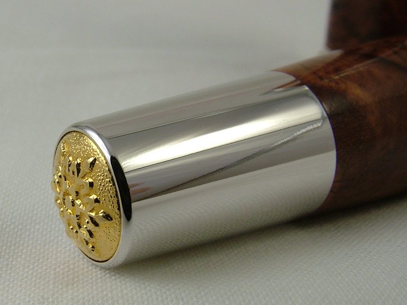

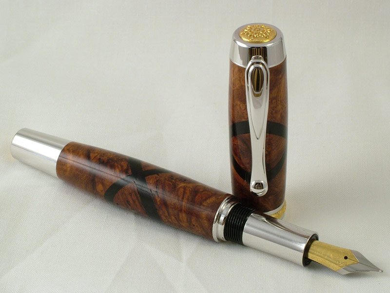

The resulting picture (a pen I turned and posted many months ago)
A close up example

Good show. It looks like it does the job very nicely, and proves that we don't have to spend a lot of money for the lighting to take nice pictures.
What fabric are you using??
gerryr
Sep 22, 2005
5,353
Billings, MT, USA.
Looks very good, but I second Russ's question about the fabric. I bought a white sheet at Wally world and haven't been terribly pleased with it. Even with a double thickness, I get more specular highlights that I want. And what kind of daylight bulbs did you get for $2.00 each?

I'm really not sure what kind of fabric it is. I went to the fabric store, looked around for a pure white fabric that didn't cost much and seemed to difuse light properly. I found this stuff for $1/yd. It looks nearly identical to the curtains we have in our bedroom- a real sheer fabric. I already threw the receipt away, so I'm not sure what it was called. Sorry!

I am (or should I say my wife [:D]) working on a similar setup using a sheer fabric like those on curtains too! I am excited now.
I bought some Reveal bulbs...hope that is the same one you used since I really like your results.

Looks great Nils, but a naive (perhaps dumbb) question here from someone who can't even spell fotografy, but realllly needs to learn...where (and how) does your camera sit when you take those close ups....that may be answered in another thread, but hoping you don't mind answering [:)]

I assume he is using a tripod. You can get them pretty cheaply...there are table top mini tripods too. Check your Walmart photo section.

John- I almost always use a tripod but the pictures above were taken without one. My camera has macro mode and super macro mode (for pictures within several inches or less of the lens). Most pics are taken in macro mode and the camera is raised a little above the pen but a foot or so back from it. I have to play around a lot with positioning to get the focus within range but with good lighting, it's a lot easier. It's hard to see but in the first pen picture (the middle one) check out the ball shape on the bottom of the clip- you can see the top of our wooden chair and my hands holding the camera. The tripod I have is the cheap $18 one from Wal-Mart but it works fine.
Dario- I think the Reveals work well. I've got a 70 watt Reveal on the right and a 100 watt Daylight on the left- not balanced but they work.

I have a tripod, but my actual question was meant to be 'where' is the cameral/tripod positioned in relationship to the pen..ie, do you take the picture from the front of the box into the open front side, I presume in retrospect that would be the only logical choice, but not sure how you I would focus the camera once its in postion and using macromode..ie, I suppose my head will fit into the opening of the box, at least far enough to see the focus site..and my arm too, to adjust the focus...?..Or is all that somehow done before it all goes into the box??

Nice Job Nils,
looks great, the only thing I would add, is if you can iron out some
of the wrinkles would help with the pic.

Great closeup. You can fine tune the various problem spots in the reflections in a good photo editor like Adobe. Please let us know what type of camera your using, I am really in need of a new one.[8D]

Penhead- Not naive questions at all. I'm no pro but for my pictures I keep the camera anywhere from 1-18 inches away from the subject, mostly depending on whether I'm using Macro or Super Macro mode. With Super Macro mode, the subject can literally be touching the lens and it can keep it in focus. I'm rarely 'in' the photo tent- mostly just near it, using my optical zoom. That way you never need to be too close. I use the autofocus where you push the shutter release halfway down to focus and that does a pretty good job.
