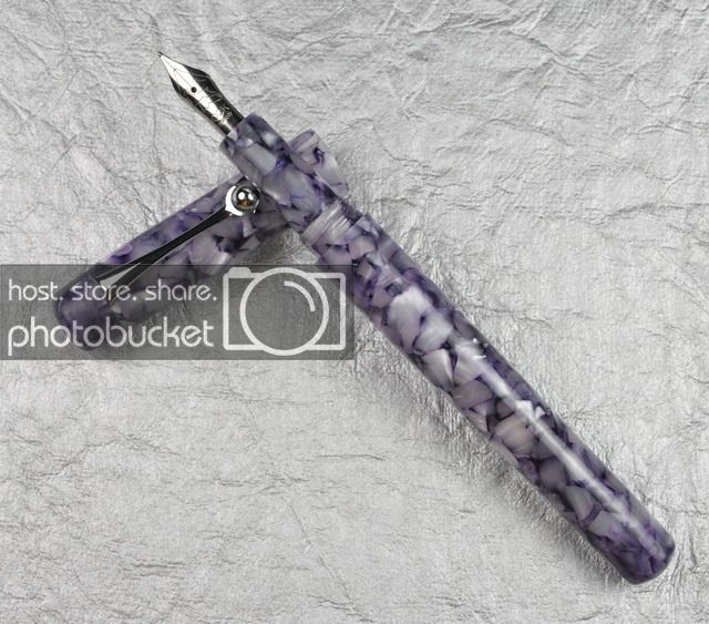

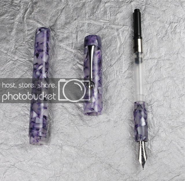

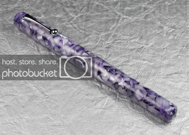

Just finished this one using 12mm, 9mm tap/die combo and #5 Bock nib. Been working to keep the cap shorter (than before) and somewhat proportional to the clip and rest of the pen.
Finished pen measures right at 5.5" long , .5" diameter in the middle. Cap is about 2 1/4" long.

Very nice. I like the no overlap cap and pearl always goes good on any pen. I don't make kitless pens but I personally think it is a big + to not seethe insides of the pen.

To me - it's a great looking pen - and I love that blank material - I just ordered something similar to that the other day. Can't wait to play with it.
A critique - to me the background takes away from the pen. It all blends together - something dark, black, would be nice. Or a low light setup over a plain white background.

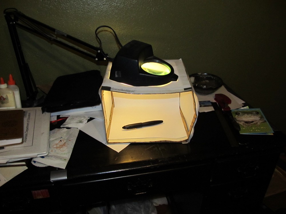

Are you using a tent or a box?

A shorter cap is something I'm working on for my current under construction pen. It, too, is a #5 Bock. One thing I'm going to try is hiding a half cm or so of the section inside of the barrel. I havent made a #6 yet, but those sections always look shorter for some reason.

Guys, thank you for the kind words and constructive critique. I probably should have titled the thread, "My Latest Pen". The going back and forth about what to call "it" has been well documented on another thread. I really enjoyed making this pen and the likes because of the challenges it presents... and in the process you learn. I think that's why many of us are hooked.
Shawn, thanks for advice. I thought the same about a darker background... didnt' realize it until after first looking at the pics on the computer. I used to use a tent but I get too lazy sometimes to set it up.
Lyle, I know the challenge you refer to. Things I have tried are longer threaded 9mm tenon of the section, shorter area of the section where you hold the pen, and if needed, drill a hole on the finial's tenon to allow a bit of space for the nib.
Brian, many thanks. I have seen your work and that of Shawn and many others that have inspired me to try.

Nice looking pen. I have found that.300" tennon on the section and section length of .787" (20 mm), along with a recess in the finial, let's me make a cap about 2.250".

Looks really nice Mark. Very classy. And with keeping the cap as short as possible the ball clip looks good. On a longer cap those clips are too short. I need a few purple pens for my stock...some of this material would be perfect.

Looks awesome on a black background - as for a light box, I'm lazy too (you have no idea how lazy and I'm too lazy to tell you), here's my setup. Takes 2 seconds to set up as I keep it stored on the floor next to my desk.

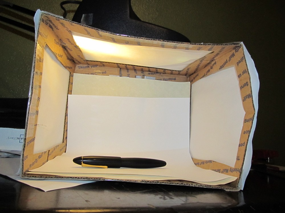

First the setup is just a swivel desk lamp squashed over a cardboard box. The box has been cut to nothing with cheap copy paper masking taped over the outside of it. I need to get a whiter light bulb instead of this yellowy thing.
You can also see I have some white copy paper inside the box as the background. I need to get a larger piece of paper so there's no line behind the pen in some photos... I'm just kinda lazy. :)
No tripod either. I just hold it there on auto usually. Sometimes I put it on "P" with these settings...
tungsten lighting
sometimes exposure at +2
never use flash
and that's it really...
Inside of the box...
