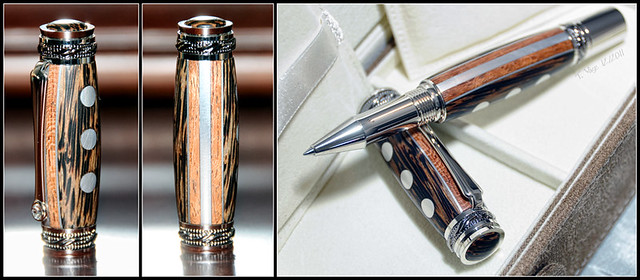

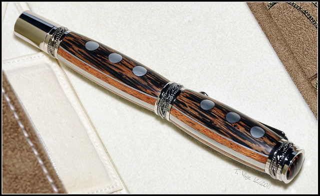

This is a pen I just finished up today. I was inspired when I went searching knife sites for my mosaic brass inserts and had the idea about doing a pen that kind of had the same backbone as a knife.
Here are the materials I used:
Outside: Black Palm
Inside: Brazilian Cherry
Aluminum: 1/8th Inch center
This pen fought me from the very start! Black Palm is a real pain in the butt to deal with, but it looks pretty sharp when finished. I put a CA finish on it and then buffed it out with Steel Wool for a satin finish look. I will also say that because of the 1/8th inch aluminum backbone the blank heats up VERY fast and was difficult to drill and blewout twice.:eek:

It really was a headache to be honest with you! I think the larger aluminum plate held the heat so well that it broke down the CA. I'll do a couple more, but I'm planning to take my time to keep the heat down.

Wow, I don't have the words to tell you how much I like this pen. But I did make one of the pics my background.
On a side note, I've used a collet chuck when drilling. But at times the hole gets off just a little. Does your method usually produce perfectly centered holes?
Not always perfect, but it does a great job. Much better than the drill press method.
