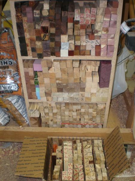

I try to keep my blanks organized, and this is my new and updated stash of blanks (thanks to alot of you guys) I have 2 large flat rate boxes more than that that are stored away in a corner for now...

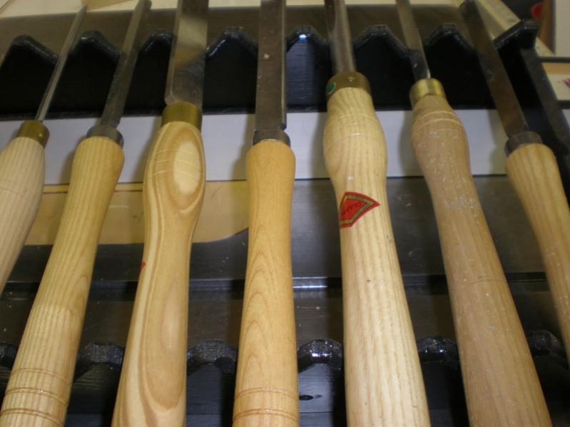

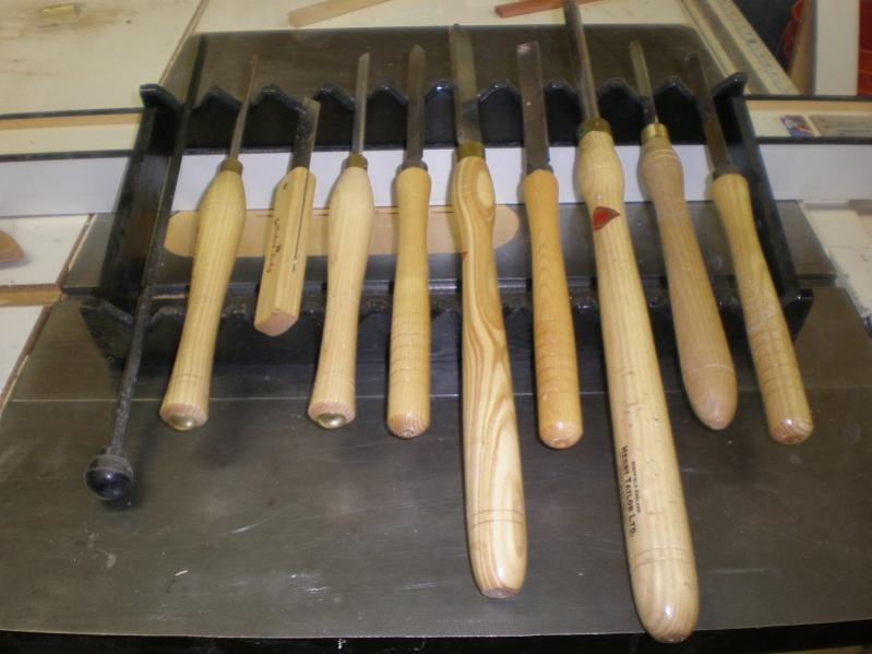

This is my tool holder made out of scrap 2x4's , its strong but also thin enough for the shavings to fall right through it because i put it right under my lathe when i am working.

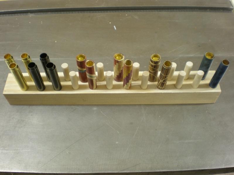

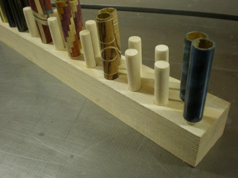

Just dowels stuck into a 2x4 to organize the tubes i still have to put on a kit, as well as the sets of tubes i have yet to make into a work of art.

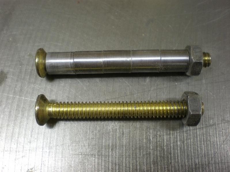

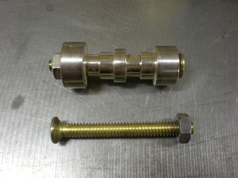

Use bolts and nuts to organize your bushings and keep them separate...

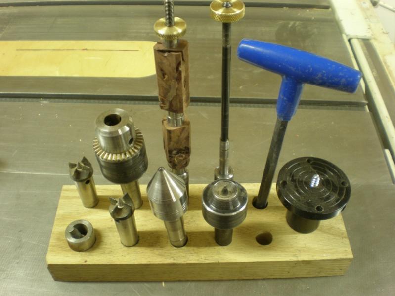

Scraps seem to be very useful in my shop... just drill hole in a piece of wood to create a strong and stable stand.

Thanks for sharing. I have built some things along the same lines for everything but my bushings. Your bolt & nut idea gave me an idea of what to make to store my bushings. THANKS

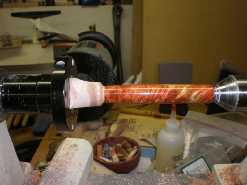

I just made another thing that has saved me time and money:

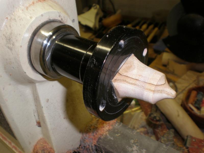

Its my rig for turning between center. its just a screw chuck with a scrap screwed on it that i converted to a dead center. best of all, i can make it any angle i want and if i accidentally glue my tube to it with ca, it is very forgiving, and can be replaced for cheap (just scraps and a screw chuck from harbor freight)
