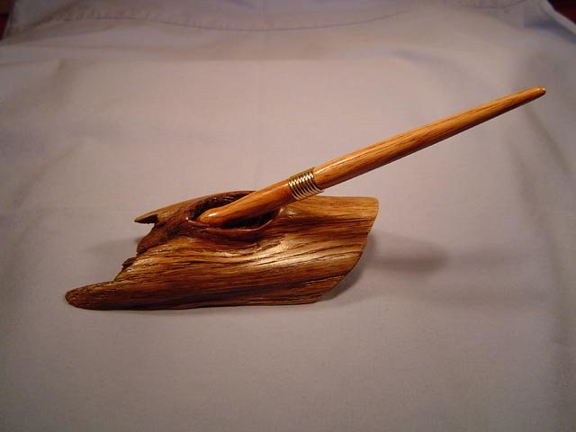

This is the first in a series of gifts entitled A Touch of New England.

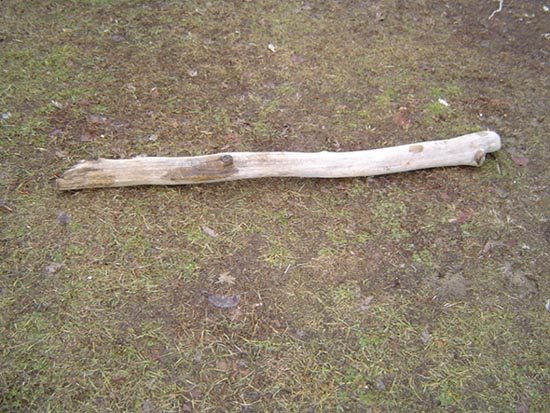

This pen and holder were made in February 2006 from a piece of drift wood found on the shore at Hampton Beach NH on November 2005.
One day my wife and I were walking along the shore line. We came upon this 4 foot long silver gray piece of wood lying on the sand. This wood seemed to cry out “I’m too good to be just drift wood†so we picked it up and put it into the Jeep to take home.
How did this piece of wood end up on the beach?
How long had it been drifting in the ocean?
If it could talk what stories would it tell of its adventure?
Did it gracefully grow old and fall into the sea?
Perhaps a storm came along and ripped it from the shore.
Is this the only piece of the mighty tree left?
Where is the rest, a house, a fine piece of furniture or unthinkably used as fire wood. This was a noble and proud tree in the beginning, but now a piece of drift wood.
So this is a story about a piece of wood that refused to give up and just disappear. It swam aimlessly around in the sea hoping to find land again and once more be a proud mighty tree.
Although not as big as it once was in size, it still stands tall and proud.
I present to you â€The Mighty Oakâ€

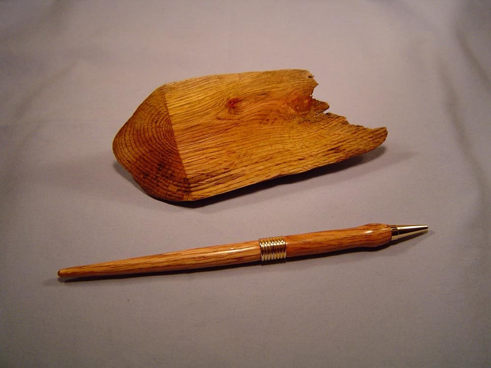

The piece of drift wood. The pen base came from the left end.

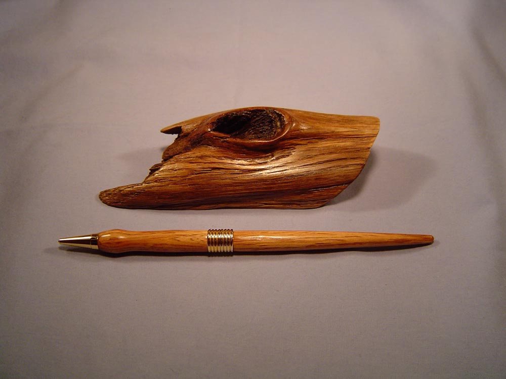

The other side

While I was trying different approaches I “invented the wheel†and found an easy way to make the top part on the pen fit over the bottom. Like a mortise and tenon. Soon as I get a few pics ill post a note about that. I only had to help the knot hole accept the pen, but I was ready with the drill, coffee grinds, old bark and ca to touch up incase I needed it.

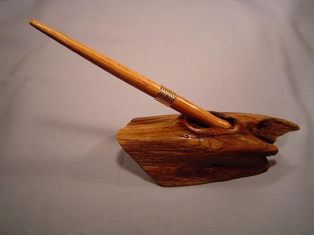

Finishing the base was the hardest. I wanted to keep the silver gray look, but it didn’t look right along side of the finished pen. Tried a few oils and polish but nothing seemed to be right. To get a fresh view of the base I decided to take a few pictures to see what it looks like. I’ve been using this trick for a long time to see what my projects looks like. It lets you look at it through different eyes. The lighting I used gave the picture a golden darker tone. It looked better than the original color, so I tried to make the real piece look like the picture.
After experimenting a while, I ended up using Old English lemon oil for golden color and some Hut friction polish (without the friction), just buffed it with old shoe brush. Then I sanded away darker spots to bring out the golden tone. I repeated this process a few times. Next I added a small touch of Deft spray and more buffing on drill press. I did this a few times as well. I have four more pieces that have knot holes, so we’ll do a few more and try again. This was actually fun, looking forward to making another one.

Pete - this makes the desk set even more meaningful. It's worthy of being printed (Done!) and saved in my file (Also done!) with warranties and other important documents related to my pen collection. Thanks, again!
