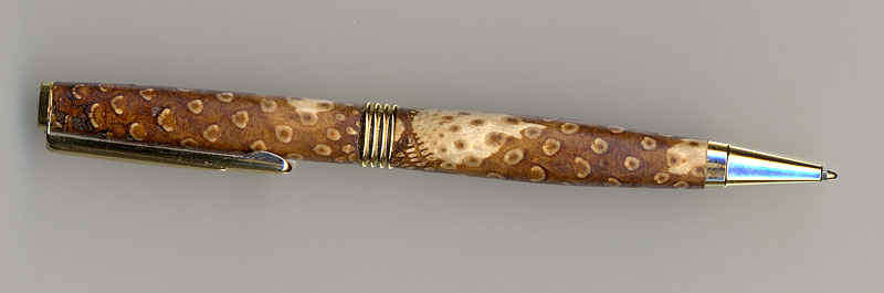

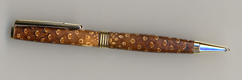

We found these next to the restrooms at Chewacla State Park yesterday, the squirrels had chewed off all the tabs and made it much easier to work with. Fortified with CA, drilled on the lathe, CA coated again, turned down and finished with a CA/BLO finish.

Using papaturners advice he posted in an earlier thread I really didn't have too hard a time with it. I think the most delicate part was the drilling, going slow with the cone in the chuck trying to keep it from breaking off at the tapered end where it got too small to be drilled. I wish I knew how to get the depth of finish he gets on his stuff.
