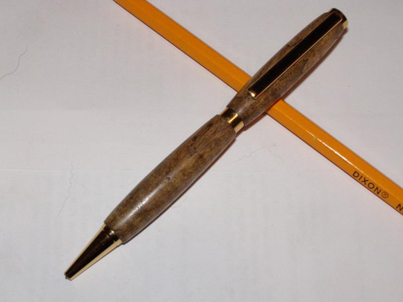

This is My first Pen i turned...made from Orange Citrus Wood .. helpful hints are welcome..steve

For one u need to take better pics. I use white paper and two energy saver light lamps ( cone shades) and a book. second I don't think ur endeges are flush ( if they aren't they can crack) but over all a really good pen!!!

WOW!!! Tough crowd. I do feel sorry for you though because you have officially been sucked into the vortex and it has a strong appitite for wallet contents, be it paper or plastic. Great looking pen. My suggestion is this and this alone. Use your bushings to get you there but use your Calipers to fit it exact. I love this link and share it with everyone. Check it out. Lots of great tips.
http://kurthertzog.com/demos.htm
The top portion has great articles, 'Woodturning Design Magazine "Journey from Penturning to Penmaking" Column'

You are off to a great start.
+1 Great website for info. I too just started a few weeks ago and this guy has some great info for turners of all levels.
+1 on Justturnin advice.
Be sure to check out the library section of this forum. Lots of great info. My head is swimming with ideas and I have a hard time figuring out what to do next.

the best tip i have for you is use a wood file when you get close to the end keeps you form going to far and you can form it better.

Luke, I think the OP's picture is in better focus than yous, and also doesn't have the distraction of the paper joint, which may actually help some pics of pens.
For the guy's first time it looks pretty good, it' looks like it's a bit proud of the bushings, and a pretty decent IN FOCUS picture.
Lets see your first pen and picture!!

That's a pen to be proud of for sure! Great Job!
Read everything you can on this forum, keep experimenting, spend some money( ok, a lot of money :), and six months from now see how much you have progressed. You will be amazed!

For a first pen this looks really nice. I for one would not use a file to finish the ends, learn to use a skew or get a carbide tool or even make one and you will see tons of difference. Well done

Good first pen, Steve. Keep at it and you'll be amazed at your learning curve as you progress. Don't be afraid to try a larger diameter pen. I think you'll find they are actually easier to turn and learn from. Good luck.

To add on, a Cigar pen is a great one to learn on. Not complicated, and generally gives a nice finished pen. There are a lot of people here who sell them cheaper than most commercial places.

Congrats on you're first pen. You're doing better than me cause it took me 3 months to discover this forum. You can learn a lot viewing all the pens here and checkout the articles in the library.

Good looking first pen and a real good start. Looks a lot better than my first pen. Come to think about it, it looks a lot better than any of my first dozen pens. :biggrin:
Someone mentioned earlier that starting with a larger pen is helpful. I heartily agree with that. Pens such as the Sierra are much easier to turn and learn on than those tiny slims. :wink:
I'm also not a fan of using a file to shape a pen blank. Too easy to turn down the bushings at the same time and make lots of metal dust to impregnate the wood grain. :frown:
Keep up the good work. :)

Good start! welcome to the addiction! make sure to save this pen, and a year from now, look back and see how you have changed as a turner. My first pen still sits in my shop and makes me smile when I see it!

Great pen! As has been said before, welcome to the addiction!
I tried to "follow the rules" on my first pen and turn the barrels straight, I like it that you have rounded the profile. You will learn something with every one you turn; I've turned about 70 (nothing compared to some here) and learn or try something new on every one, tons of fun.
Now you need to double what you thought the max you would ever spend on pen making and add a little...:rolleyes:

Well for your first pen, pretty good! Yes the blank is a bit proud of the mating parts but I've seen that in pens made by folks making pens for years.
If I could make one suggestion, try another kit like the Sierra. They aren't that much more expensive than the Slimlines and in my opinion they are hands down the easiest pen to make and they look nice.
Whatever you do.... DON'T grab a file to turn the blank down! Learn to turn and sand if you have to but don't file! :eek:

There are times when a file can come in handy, but a much better tool to master is the skew. With practice you can get the exact profile you desire and really reduce the amount of time (and expense in consumables) required in finishing. I typically can go to 320 or 400 paper after finishing with a skew.
Part of mastering any chisel is mastering how to sharpen them as well.
