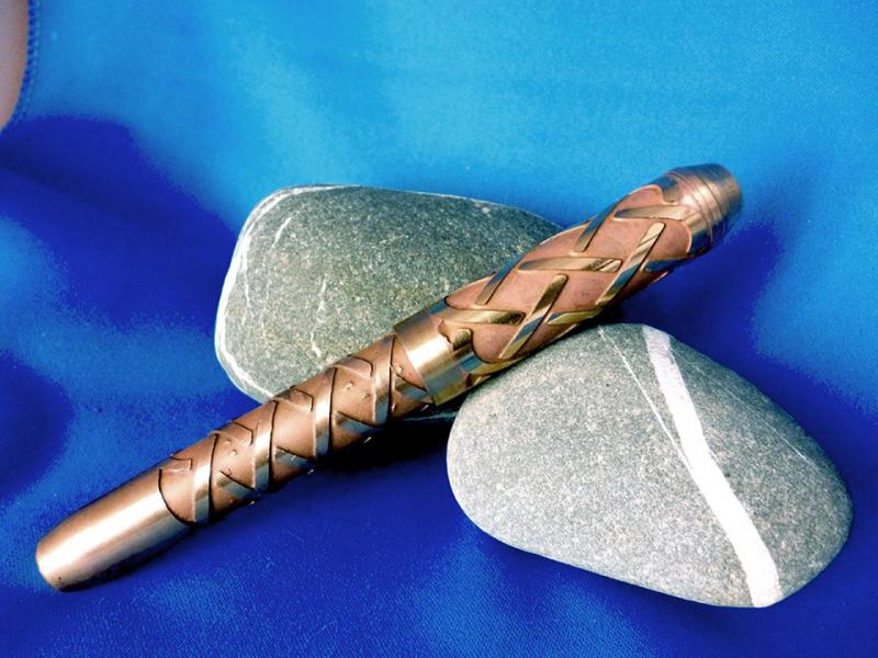

Well, here's my first pen after crossing the kitless bridge :)
Etched from brass, closed body and lid, and as you can see no clip.
Ive left this one looking very bare intentionally. some may feel it looks unfinished, but for me, it shows me the result of my recent success of etching, without hiding the work with resin. The bare brass shows me the foundation of what i can plate gold or chrome.
This pen is more of a piece which will sit in the middle of my collection of etched pens, being an example of what lays beneith the plating and resins of the rest of the pens in the collection. So as people asks how was that done? I can show them this pen. bit of a trophy pen for me as well i guess :)
and as always, Thanks for looking

Congratulations on your first kitless pen Brad. Now.....I believe I like it as it is, without the resin fill. That's just my opinion. Actually, I like everything about the pen. Nice work :wink:

I love this! It has an historical artifact look, like it could have been found in an archaeological dig. Just too cool!

Thanks for all the comments guys :) has a bit of a Roman feel to it to me. Learned alot from this one with how to go about turning a kitless. Needless to say theres room for improvement in how i go about that but lots of time to reap Chucks, Docs, Stevens, Mikes, Marshalls (and everyone elses i missed) knowledge on the matter :biggrin:

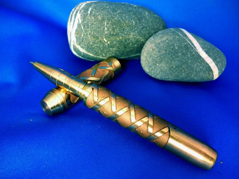

I can add to the pile of "WOWS"!!!! too, really specail.
How do you access the ink stick(I just didn't see any seams for the threading, but it's there somewhere)....thinking through the nib maybe?
What ink stick can you use in this?
Will the metal turn 'green' like most brass does over time, or did the 'treatment from etching' take care of that?
Scott (wonderfully done) B
BradG
Jul 10, 2011
1,733
Blackpool -UK
Brad thats almost pen porn 'cept that its beautiful how heavy is it?
Heavy ;) dont have any scales with me to tell you exactly, but i like a heavy pen regardless.
Takes the same refills as what the Gents take, the entire nib unscrews at the point where you can see the threads for the lid. I did take a picture of it all unscrewed in sections but the picture came out very yellow so i didnt upload it.
Yes, the brass will tarnish over time, though not so much if the pen is actually being used as the rubbing from your hands will counteract this. They can be treated to prevent it from tarnishing, though i think i may just let nature take its course on this one. Can always just polish it in the future if i change my mind.

Overall, I love it, but for me the narrowing of the grip section doesn't work for me. I think the grooves would have sufficed.

I agree, it looks tacky. I was trying to copy the profile on a hent kit but regretted it afterwards.. C'est la vie... i successfully ruled out one way i dont like :cool:
