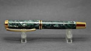

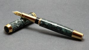

I ordered this from Exotics thinking it woudl look nice of a Jr Gent. I did not realize how this the rod was. It was 16mm. I had hardly any maeterial left after drilling so room for error was small. I had some luck with it though. It is not perfect but I like the finish.
All the time while I was drilling it I had problems. The bit would get stuck because of heat of the plastice and would spin the round blank in the vise. It took me forever to drill this. After all the cursing I wondered why people use this stuff. Then when I saw how it finished I understood. It has a certain depth to it that makes it look nice.
Thanks for looking...
