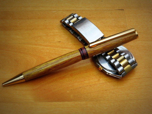

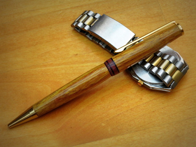

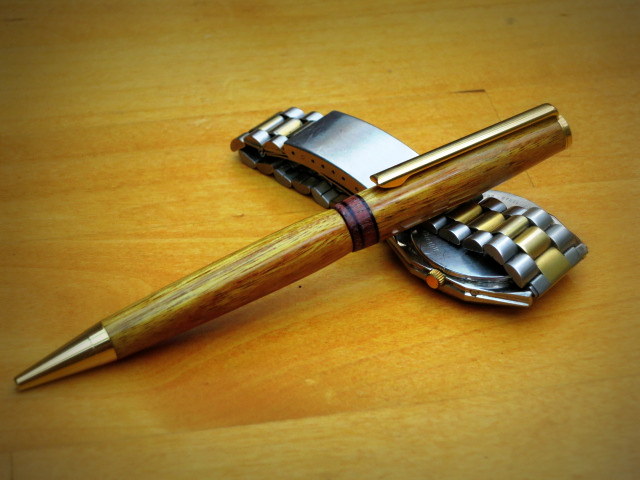

My fifth pen - final of the first series
See more from vferdman
vferdman
Aug 23, 2014
263
Western Massachusetts
I just completed the last pen in the series of five kits I bought along with some basic pen tooling (mandrel, pen mill, bushings). This one I am not sure what the wood is, but the band on the end of the cap is purple heart from scrap I had from pen #4. I decided to do away with the center ring as in pen #2, but wanted to create a look of a cap posted to the pen. I think I achieved it mostly. I could have gone a bit more dramatic in making the "cap" a bit larger at the bottom, but I am pretty happy with the result. My skew skills are improving and I am really loving the slimline kit now that I don't have to use the center ring.
Here are all five of my very first pens in order of creation from left to right:

The center band is certainly a nice modification. The purple heart goes well with the whatever-wood-that-is on the rest of the pen. You have accomplished early on what some have take quite a bit of time to do. Well done.
If you want to expand your Slimline skills, check out Don Ward's (its_virgil) book Turning Modified Slimline Pens, Beyond the Basics.

After rounding the blanks I used a skew to cut the width of the custom ring down to the tube on the cap side of the blank. This needs to be done such that there is a perfect square angle from the tube to the remaining wood on the blank. This will make a joint between the custom ring and the rest of the cap. I then took the blank off the lathe, drilled a normal 7mm hole in a purple heart scrap and squared it with the mill using a spare brass tube without gluing it in there. Afterone end is square, I glue the scrap with a hole in it to the empty tube and squared against the cap material. After that's dry I square off the end of what now is a top (cap) blank with a custom band blank. I then go back to the lathe and assemble the mandrel without the middle bushing. Then I turn to my heart's desire the shape I want. I have put a burn ring on the joint between the two woods because there is usually a dark line of glue there anyway. You could leave it like that, but I enjoy doing the burn rings. I just use the skew to put a tiny groove there and then use steel wire to friction-burn the ring. On this pen I also put a second ring just for fun. So the ring is not free floating, it is part of the cap and there is no perceptible seam. It's a really cool way to make a slimline. I will definitely do it again. Would work great with a piece of pearly resin, I think.
