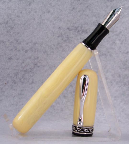

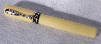

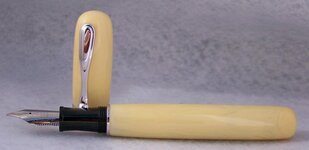

This is my first attempt at a double closed end pen as well as a hidden clip. The blank is a banded ivory TruStone from R&B crafts. I used the centerband and threads from an Rhodium Olympian Elite kit and used a clip from a Jr. Retro. MM to 12000 and buffed with tripoli and white diamond. Polished with PlastX and a coat of Ren wax. Any comments and critiques welcomed and appreciated.

It's very nice. The cap end seems a bit short to me visually, but that may just be the photo. Beautiful work on the hidden clip.

it is a bit shorter than I wanted. I've never had a problem with any of the trustones I've bought but on this one I had an air bubble show up on the end and it chipped off. I wasn't able to save it so I had to shorten it up a tad, plus I was wanting to not use the stock centerband but with the chip out I had to bc it added the length that the chip out lost.

Very nice work indeed. What mandrels did you use for the top and bottom?
I used transfer punches mounted in my barracuda chuck. For the cap I had to grind off a bit of metal and add a pin chuck. The body the punch was a perfect snug fit so no altering for that one.

Very nicely done! Thats too bad you had the blowout, it would have looked great without the centerband, not that it doesnt look good now, but you know what i mean.:frown:

I do, I didn't want any color except the clip and the blank but since I haven't tried the kitless tap & die methods I had to go back to this design.

Very nice pen. My attempts at invisible clips have all failed. You did a very good job!
