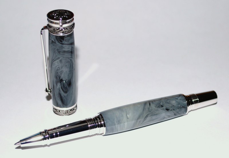

The second is a Black Ti Majestic Jr on what I named "Rolling Smoke". The blank was cast with Silmar 41 with Antique White and Grey dyed resin swirled in transparent black. The hole and tube were prepainted black.

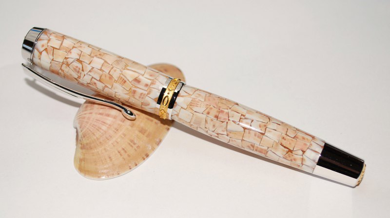

The last one is a Jr. Statesman Sea Shell pen. The shells were given to me by a friend who spends lots of time on a Florida beach. The shell pieces were glued to a colored tube before casting. A pretting simple pen, just time consuming.

Those are a great set of pens. I really expected the feather pen to be in the finals. The other casts are outstanding as well. Is there a trim ring missing on the Majestic?

All great looking pens john! well done,my favorite is the shell pen! would of been a real pain on the fingers cutting and fixing all those shells, also just wondering what glue did you find worked best with gluing the shells.

Thanks all. No parts missing, just poor photos and lighting. Lol
As for the glue, medium CA is what I use on all of my shell pens. Just make sure to let them degas for several days before casting.
