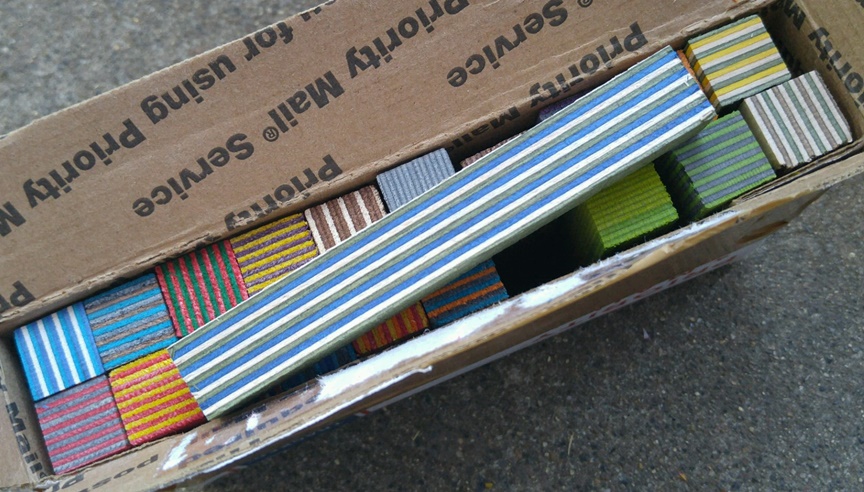

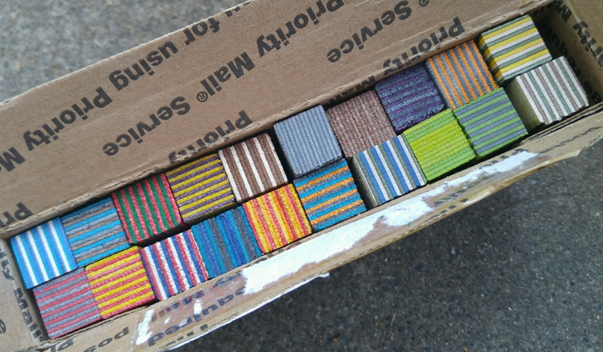

I got mine Saturday. They look nice, but feel light and soft, not like Dymondwood. I'll see how they are when I turn one.
You obviously never worked with it before from your comments. It will give the pen a lighter feel then. Nothing at all wrong with this material. I have worked both but hard to find these days. A deal that could not be passed up. Show us a comparison when you have a pen made up. :)
