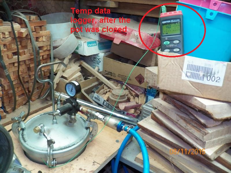

Recently (a couple of days ago), I decided to actually measure how hot these molds of mine were getting, when the curing process reached its maximum point/stage.

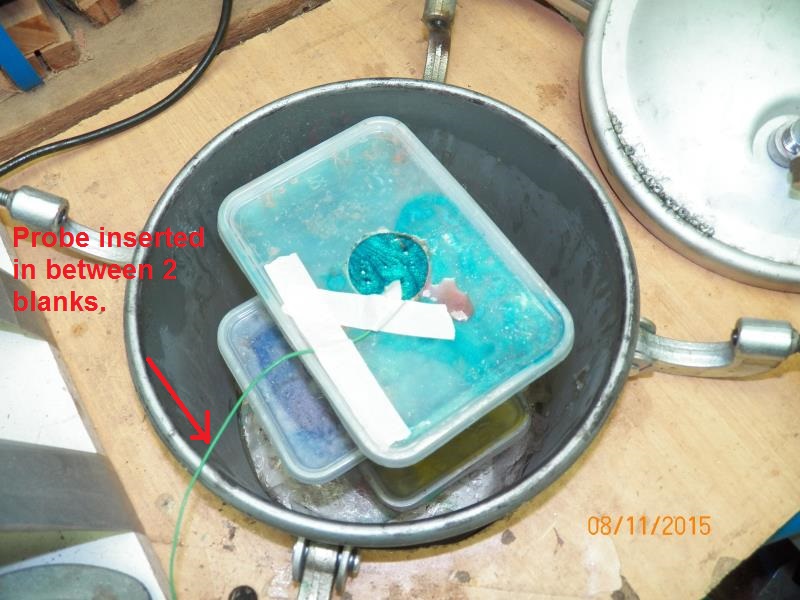

I have proper temperature data logger, used in many other situations before so, was not difficult to set the probe into/in the middle of, one of my molds, just before they went into the pressure pot.
In winter, I had to wait over 1 hour before the resin would start to thicken, just slightly, jelling with occur within 15 to 30 minutes after that however, in hotter days, such as those experienced here in recent times, the waiting time was dramatically reduced to 15 minutes, in really hot days. So far, the highest I experienced while trying to cast was 35° Celsius, a couple of days ago and, I almost stuffed things up, as I had 6 molds to fill and mixed 8 containers with 500ml of resin in each, I certainly pushed my luck, by the time I had mixed the colours/powders on the last cup, the resin was getting far too hot.
I was lucky that I had everything ready for the probe so, was only a matter of putting it in the middle of the mold (between 2 blanks), put the lid and get it into the pressure pot before it would too late.

I printed the graphic but, I had forgotten to get the date and time updated on the logger and the last time I used it was in 2010 so, times and dates are all wrong however, the important info, is all there and very clear...!

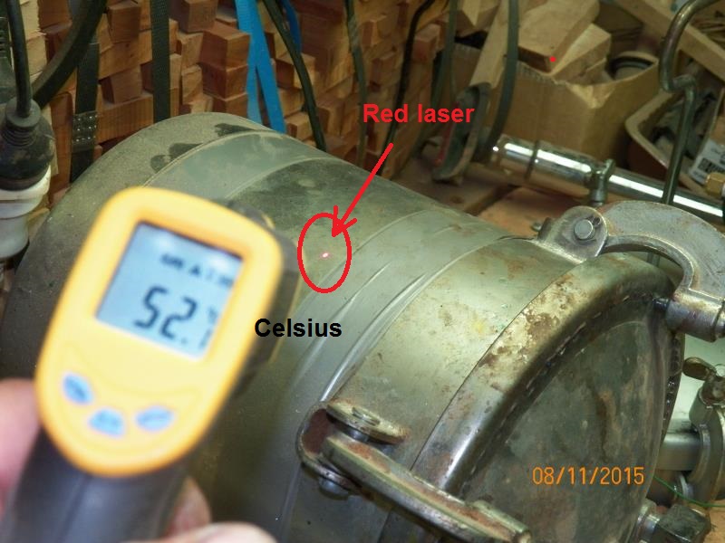

PS: The pic with the laser temp reader is to show everyone how hot the pots will get when the resin is reaching the top temperature, inside...!:eek::)
