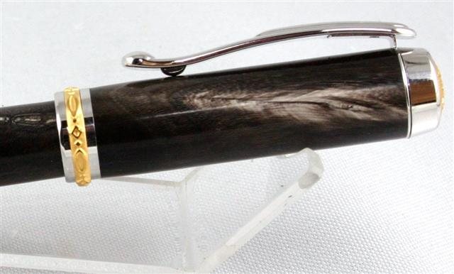

Anyone who has turned Water Buffalo horn knows that as you turn it the horn will change some times it will totally surprise you. This one was all dark brown until:
this feather showed up.

Brewmeister35, Water Buffalo horn is not as bad as antler but has an odor somewhat like burnt hair.
James here is a close up of the cap.

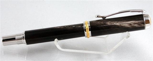

Roy, that is an extremely sweet looking pen, some times the unexpected surprises are way better than what we had envisioned when we started the project, that's the nice part of being an Artisan, we can deal with it.;););););)

That is a very nice piece of horn! Great choice of material and kit.

Very VERY cool. Ain't it grand when stuff just happerns out of the blue? Impressive job as well (got to help mother nature along a little I guess?)
