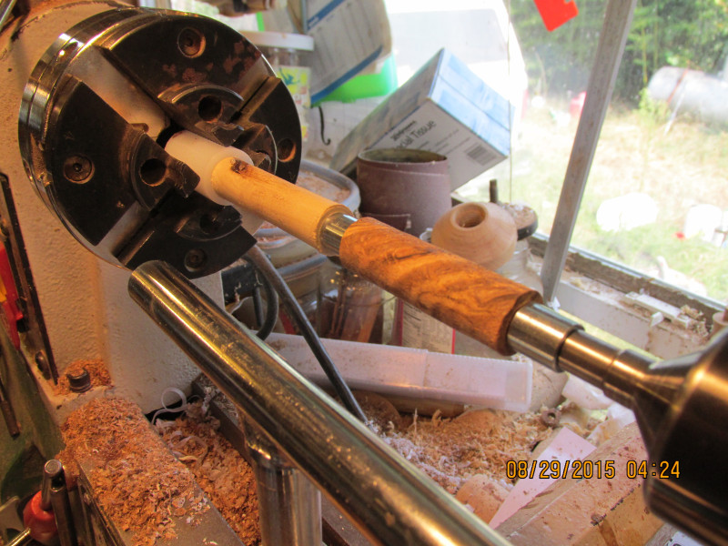

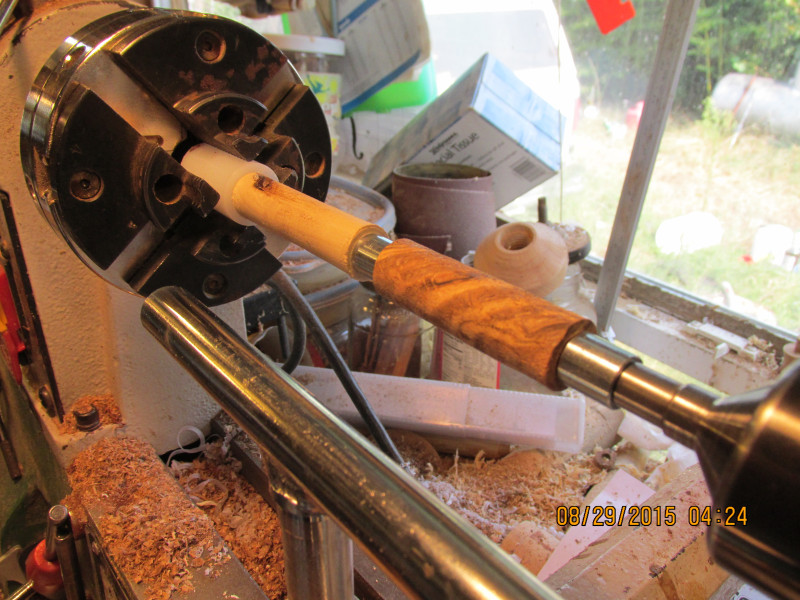

This is what I put together. but it's just a proof till I redesign. A short piece of HDPE with a B letter drill hole through it (matches mandrel). The mandrel is inserted (without morse taper adapter) into the hole. The B letter bit makes a snug fit in the HDPE so I don't have to worry about it falling off when I'm changing out. The blanks and bushings are inserted, then the mandrel saver is tightened and you're ready to turn. The white blank on the left is just waste to get me away from the chuck, I will probably remake all of this in brass and get it as tight as I can, I might glue it on.
Skie might me right as I'm relying on friction between the chuck and the blank to turn everything. I did turn down a square blank ok. It stopped about the same number of times as the other mandrel before I got it to the right tension. Still need that washer tensioner.
This is going to save me a lot of time. And no re-Morse. Was there a code?:biggrin:

TurtleTom
Jul 24, 2015
701
Checotah, Oklahoma 74426
Solution found, but why isn't the simplest winning solution more obvious?
I had just assumed the chuck throat wasn't big enough or long enough to capture the entire mandrel head WITH the #2 taper. But it did. All my chucks (4 PSI CSC2000C Barracudas) will clamp on the whole thing. I just wish I was getting a government grant to waste that much time and energy when it was so simple. It runs very true. I'm so glad we discovered this before my TBC building material got here or I would never have gone this far with it.
No need to remove chuck to use the mandrel.
(Many thanks to Paul who began this line of thought)

Are you clamping the #2mt directly in the 4-jaw chuck?
Or are you clamping on the nose of the mandrel, allowing the taper to pass through the chuck?
TurtleTom
Jul 24, 2015
701
I tightened the mandrel in the headstock and tightened the chuck onto both sections of the headstock with the #2 MT behind the jaws. Pretty amazed it worked.
I have several jaw types, some have teeth and some don't, I'm not sure which is best yet.
I even tried it with the mandrel loose in the headstock to test my theory on friction and it worked fine.
We ferreted that rabbit right out of that hole Paul.
