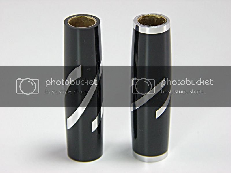

Had some time in the shop today.
Here are the blanks that I had started some time ago and were seen when I had shown the jig I used to make my feather cuts. I did 2 blanks. One on the left is a 60 degree cut and the one on the right is a 45 degree cut with a couple rings on the ends. Each is black acrylic and aluminum inlay. Both are Sierra Vista kits. I did the 2 cuts to show the difference in look and that either angle is just fine for these simple cuts. There is so much you can do with this simple cut. More to follow. As always any comments or questions are always welcomed. Thanks for looking.

Thanks Mike. As the old saying goes KISS (keep it simple stupid:)) That is what makes some of this segmenting great. It is simple geometric designs that happen when things are turned round. The swirl design has so many possibilities alone. I am going to take this idea a step further on my next one and see how it comes out. It may take a few practice shots to get the depth of cuts right but will post if something good comes of it.

Thanks Mack but I am no master of anything. I do like experimenting and do not like boring blanks. I think the blank is what gives us that WOW factor. I am hoping to now be able to get in the shop more and try new things in the next couple weeks.
Mack I am glad you gave these a try. I am with you on the 60 degree thing because it streches out the design more. I did the 2 pens using the different angles to give people an idea what they look like doing this. As always everyone is different when it comes to taste of designs and they can choose for themselves or create something totally different.

Nice work John. :wink: Kind of reminds me of a couple I did about 5 years ago also with a homemade jig :biggrin:
Making the cut depth beyond the mid point adds a little 'tick' like the Nike logo. Looks cool if you can get to curl back on itself like that. You have to use thin material though. No problem if you cut too deep as you then of course just end up with a Celtic Cross style.

Skip you are correct on all accounts. That is what makes this simple cut exciting. There is so many different possibilities. Just by using the bandsaw can take it to a new level and you can make thinner cuts as you did. I am sure you did not use a bandsaw but not all people are setup with their lathes as you. But it can be done with simple wood tools.
