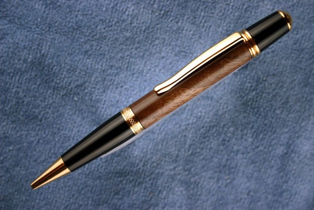

Just so Frank (Rifleman) knows that I do work in North American woods, here's the "King" of domestic woods...crotch walnut.

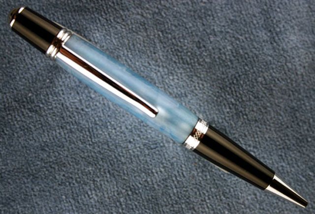

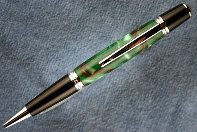

And to prove to Anthony (PenWorks) that I do occasionally work in resins, here's a sky blue and an "Andes" mint.

Lou....Those are really Great. The more I see of that kit the more I like it and you have given it a nice flair. Thanks for sharing them with us. I like the blue the best.
Jim Boyd
Aug 4, 2005
350
Montgomery, Texas, USA.
Is that kit considered a "fat" kit? Would it be compatible for segmented stuff? It looks like it would not go to good with a arched type barrel. Nice pens btw. I like the green acrylic.

Great pens, blanks and photos. I have a couple of those kits that I can't wait to make. The sky blue looks like it is illuminated from the inside.

Both resin pens are platinum fittings, since they are destined to be gifts. The walnut pen is Gold titanium. Finish on the resins is Micro-Mesh to 12000 followed by plastic polish and TSW. Finish on the walnut is sanding sealer, Micro-Mesh to 12000, six coats of lacquer topped off with TSW.

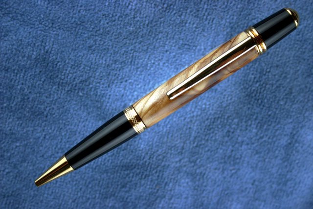

I particularly like the olivewood one......Hey! Didn't you make an olivewood one? As usual your pens are top notch. I'll have to pry your finishing technique out of you because it is sooooooooo nice.

Not many other items to address, but here goes. The sky blue acrylic rod is from www.pipemakers.org . It is so translucent that the light really does shine through it in many places. (You've GOT to paint the tubes!)
The walnut is a bit difficult to get to look good both in person and even more so in a photograph. Next to bog oak, it's the most time consuming to finish.
Yes, Mudder, there is a Bethlehem olive wood Sierra.
