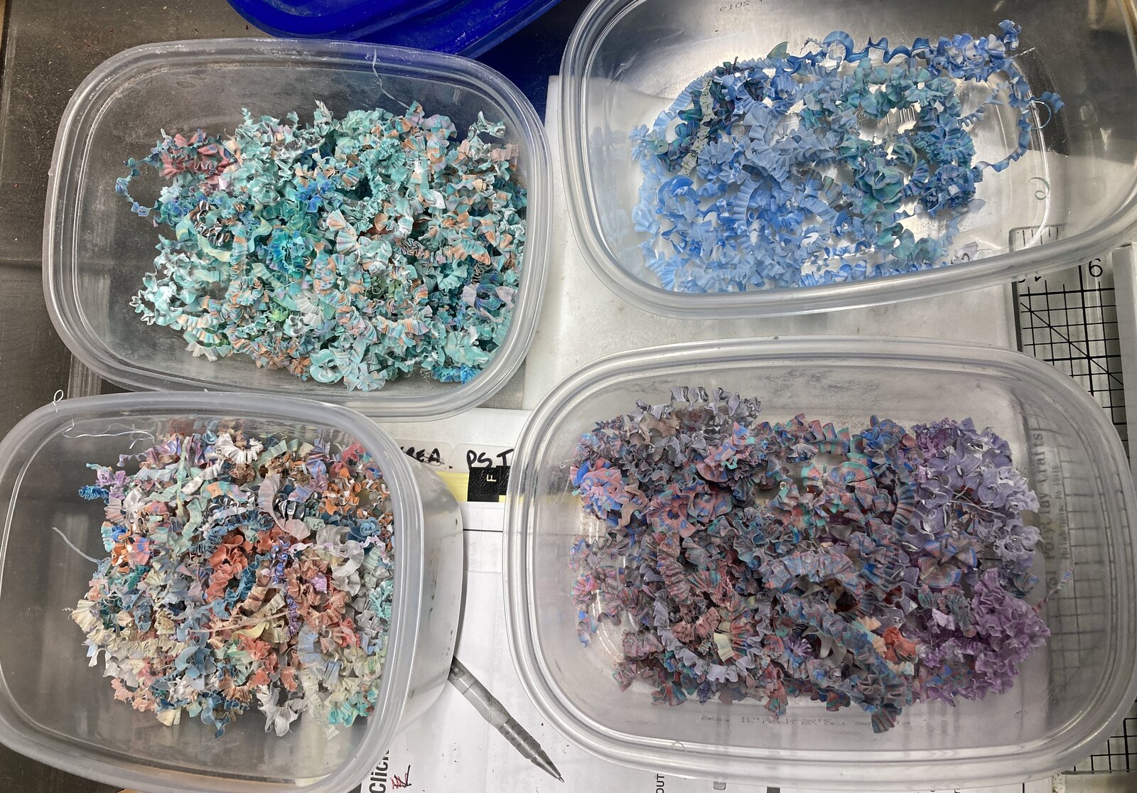

I spent some time this weekend sorting some of my drill worms (from my catch bin under my lathe) into similar colors.

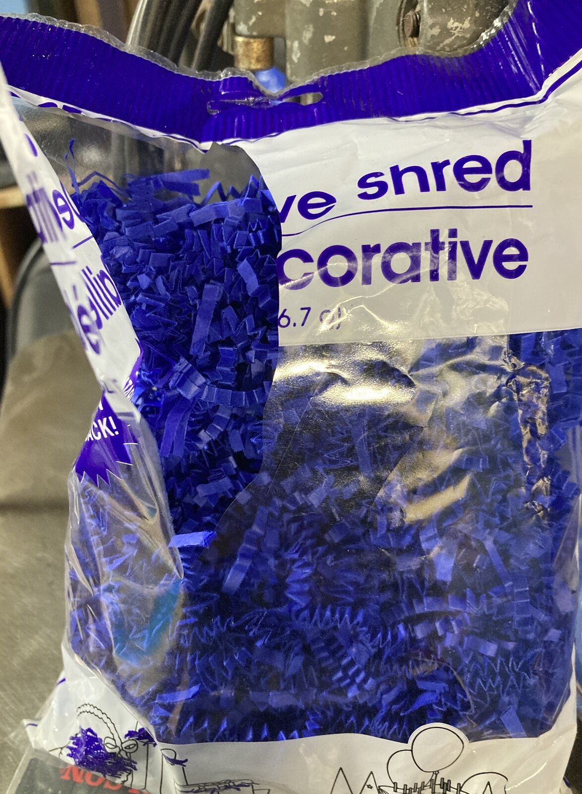

I also found a bag of shredded paper that looked like it could serve the same purpose as the drill worms.

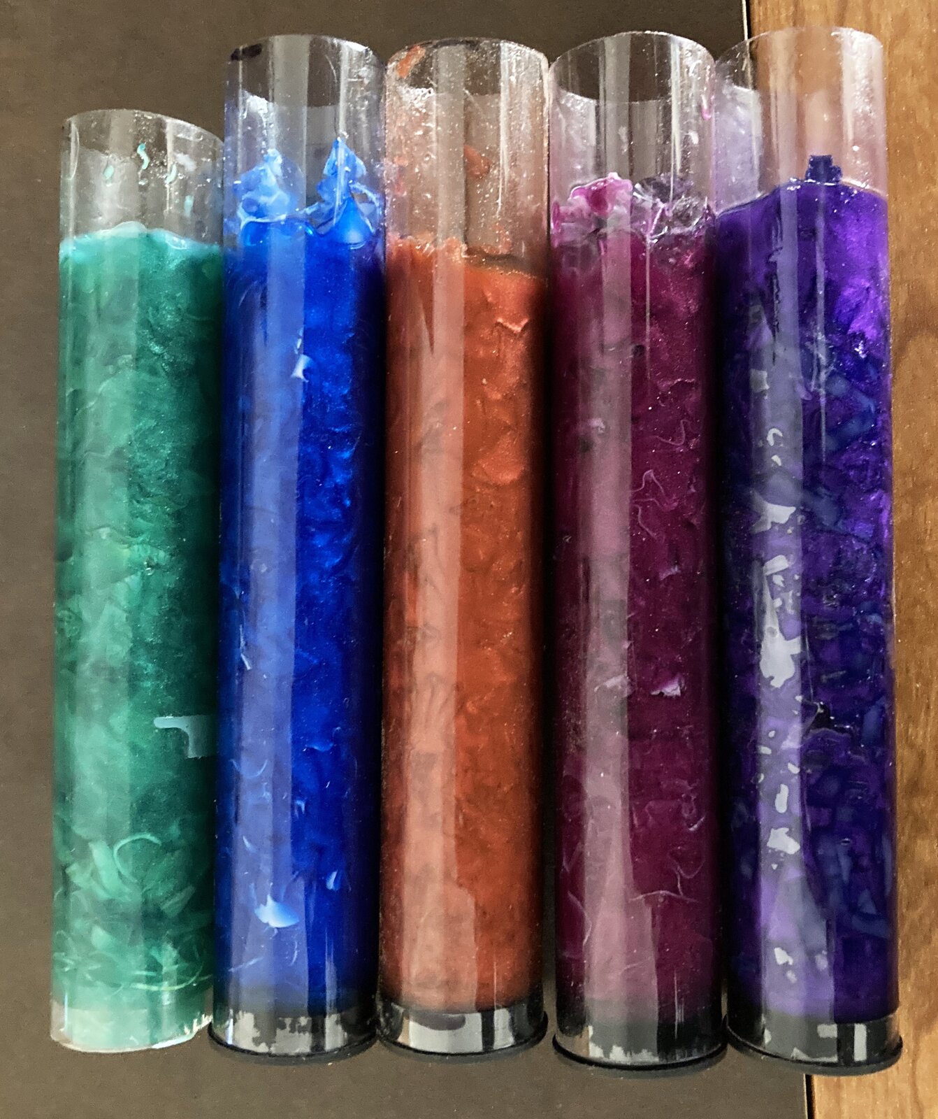

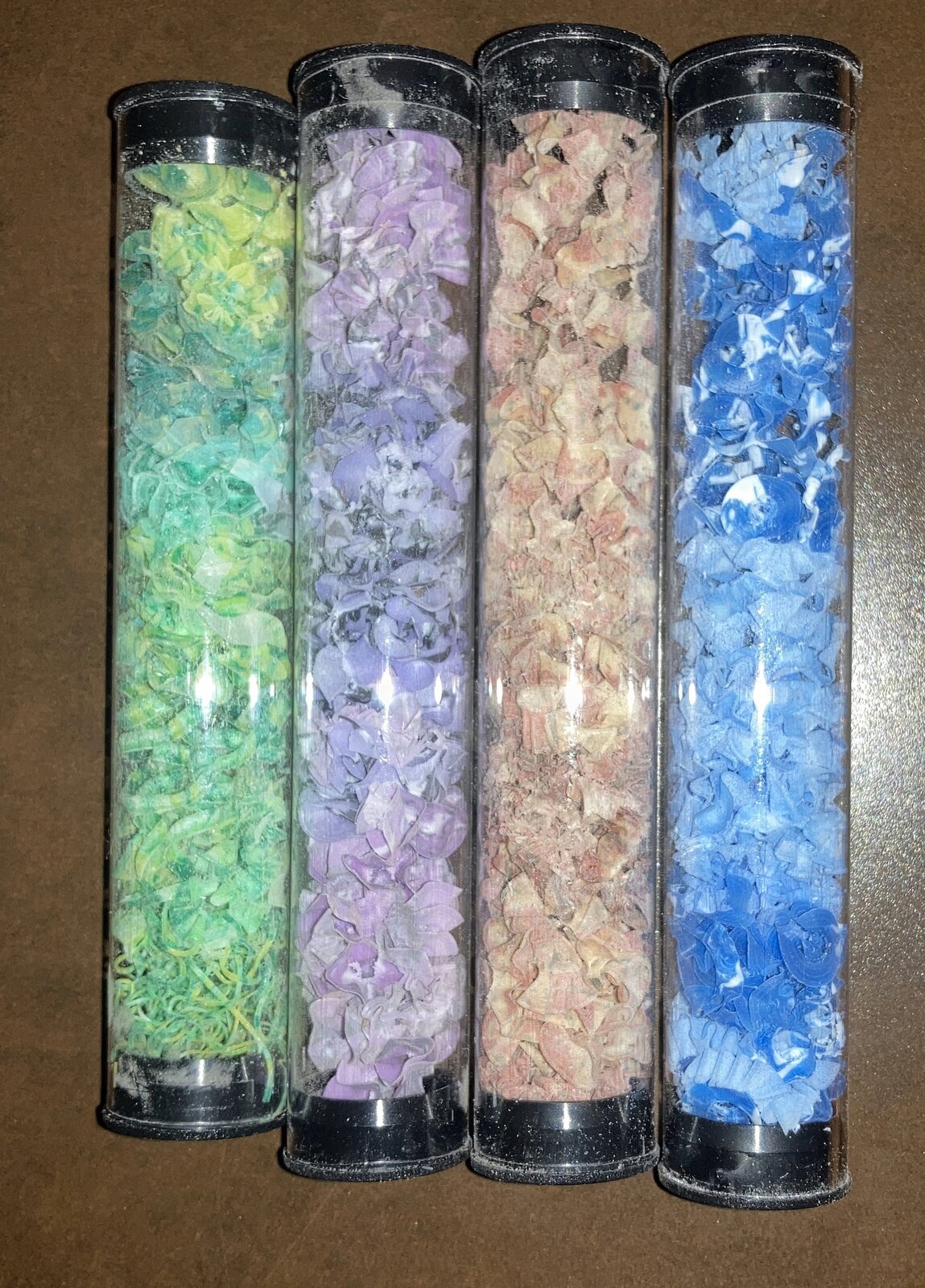

I measured some of the worms into tubes,
Then I mixed up a batch of resin, separated into 5 separate colors, add dye and some mica powder, packed the drill worms into the tubes, poured resin over them, used a large diameter dowel to pack down the worms into the resin, then into the pressure pot for 4 hours.
I'm excited at the results I have so far. We'll see what kind of pens these will make, but I have a good feeling about it.

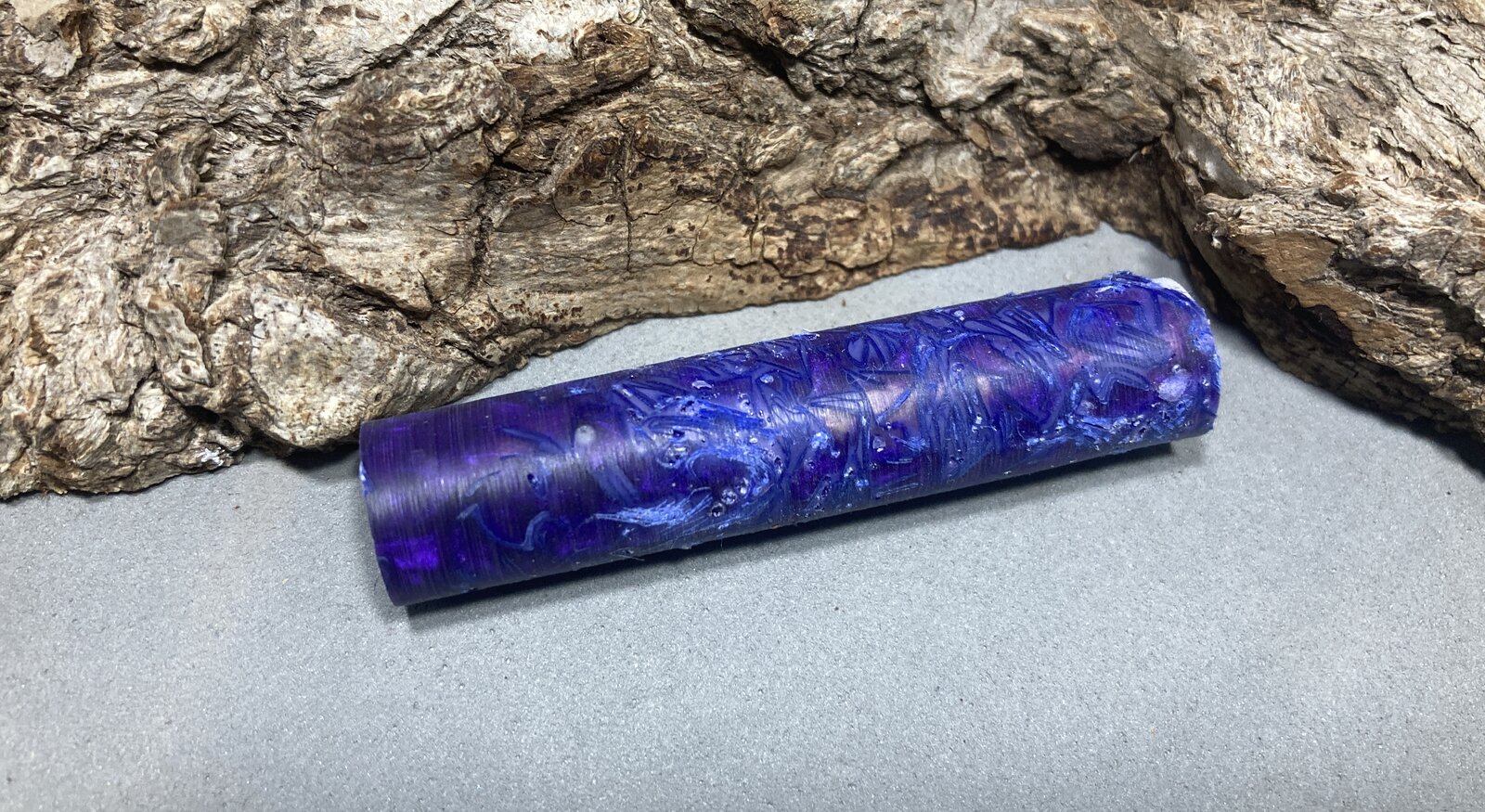

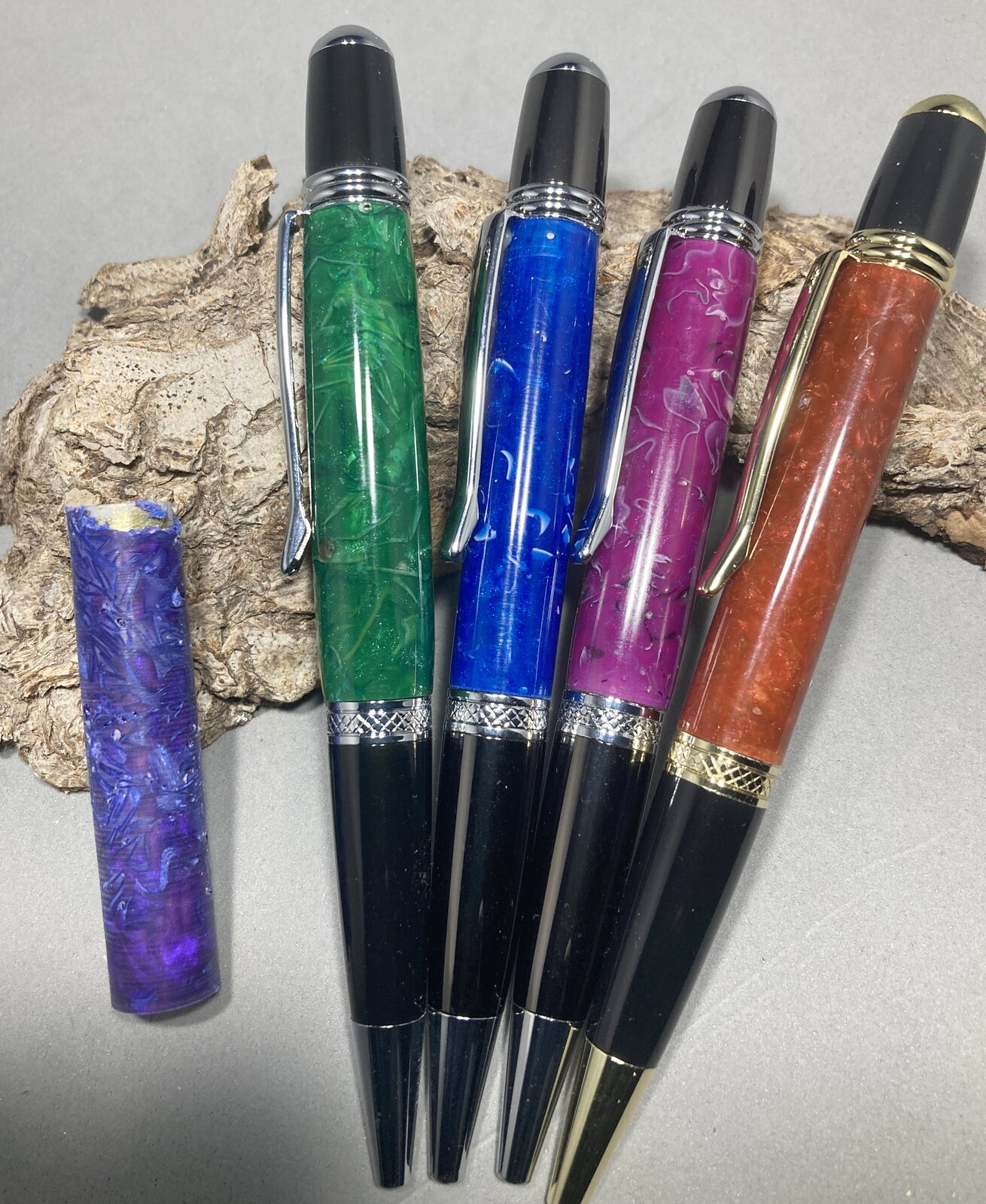

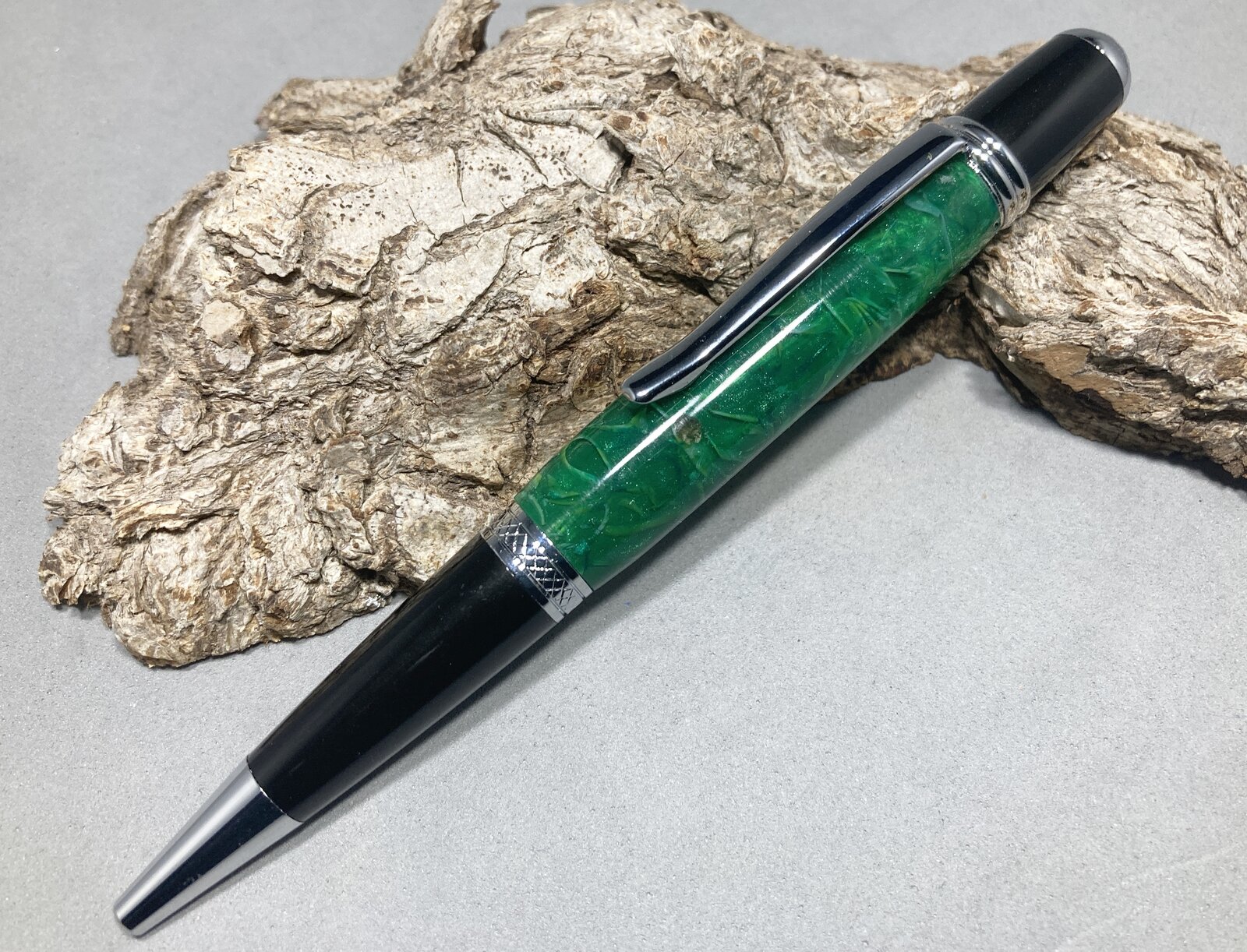

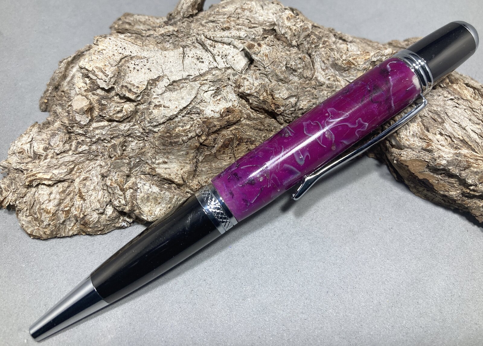

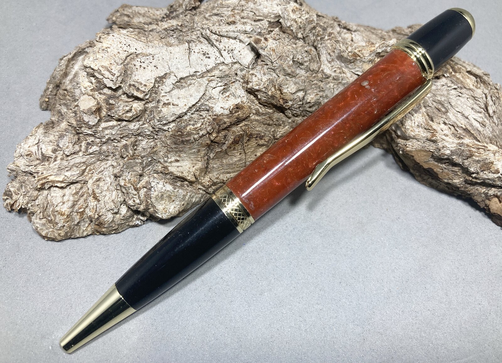

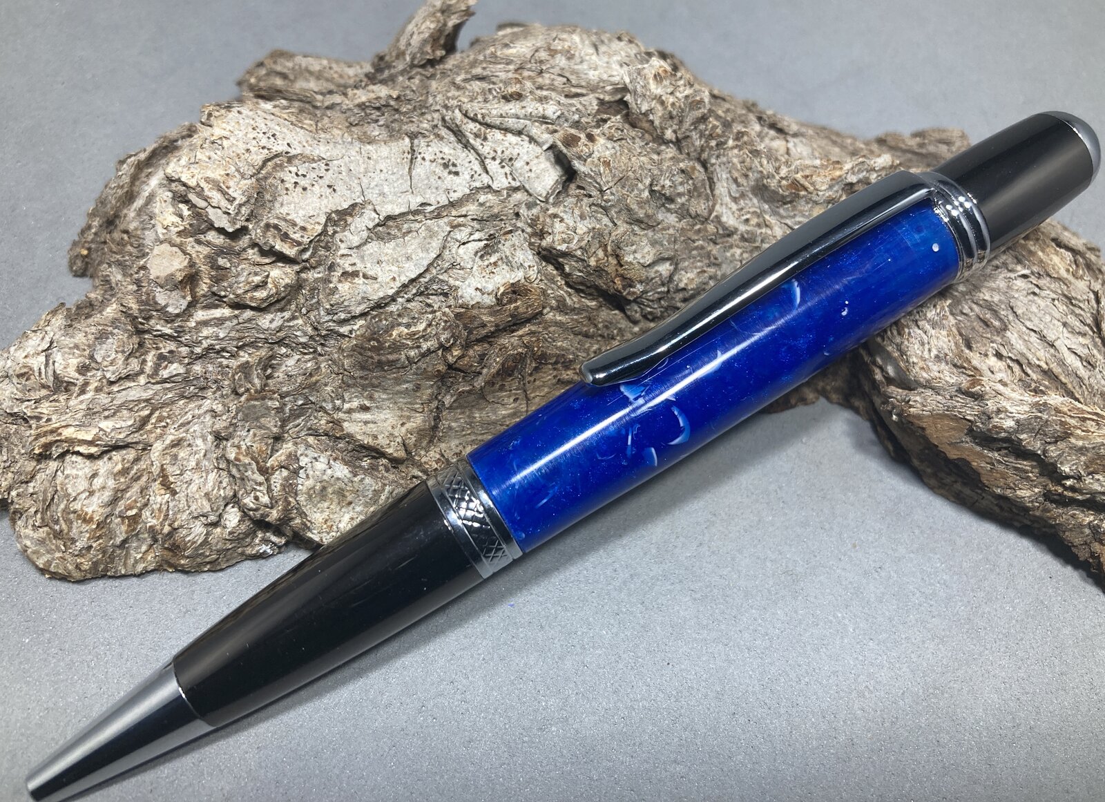

I turned each blank, and the pics/results are below. Spoiler Alert: It's not worth it. All of the blanks had some-to-many voids (likely trapped air bubbles), as well as some discolored spots, no doubt due to foreign matter caught up in the drill worms (I did dig these out of my waste bin after all...).
The purple-ish blank with the accordion paper strips blew up on the lathe twice. I think the paper strips weakened the blank, so as I got down almost to the bushings, twice, pieces of the blank flaked off. All of the other blanks turned ok, but I had to use a lot of medium CA to fill in the voids. The green blank was really the only one with some interesting "figure", but it too had blemishes. Bottom line, I won't likely be adding this to my stock of blank making methods.
