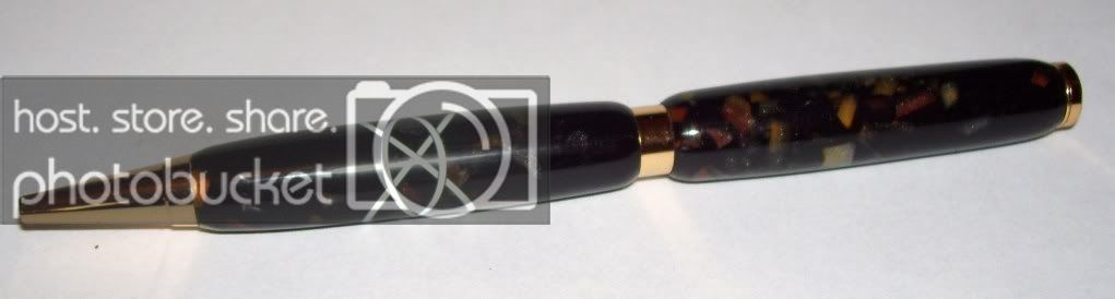

Transam
Feb 17, 2010
19
Midlands UK
this is one done with acrylic.
Cut on a band saw with a metal blade fitted.
the inlay is a credit card cut up and glued with thin ca
