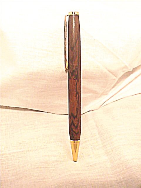

Here's my version of the slim line. I hate the center band, unless a customer orders it with the center band, this is how I make all of my slim lines. I sell a lot of them this way.
If you have any questions pm me.
