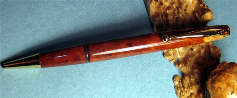

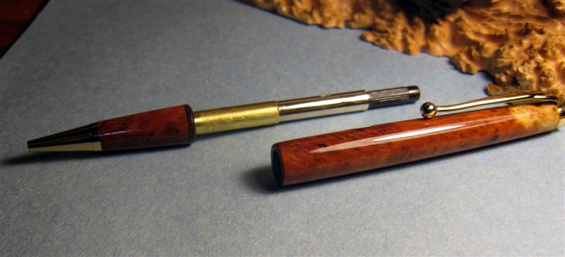

I made another tonight in red mallee burl with a macasser ebony centerband.. the second photo may help explain how its done..
Finish is ca/blo..buffed with ren wax and tsw

Thanks Harold, I think I understand. when you are turning the upper tube, do you place a tube in the blank along with the glued tube to stabilize the wood, then remove it after your finished with the finish? thats a great pen and your finish is perfect.

Thanks Laurie..I turn them round seperately..get the ends squared up, then put them together to get the two mating ends to match up and the shape right..then I sand the whole thing..then take them back apart to finish them
